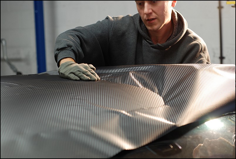

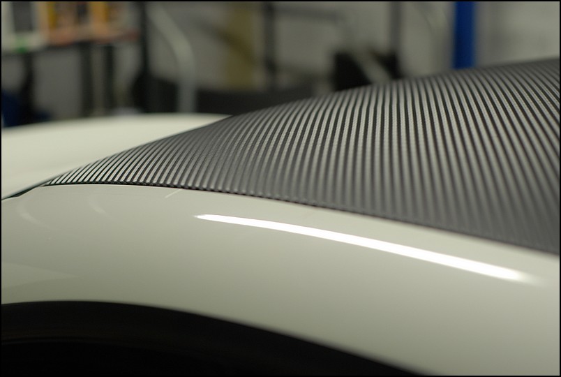

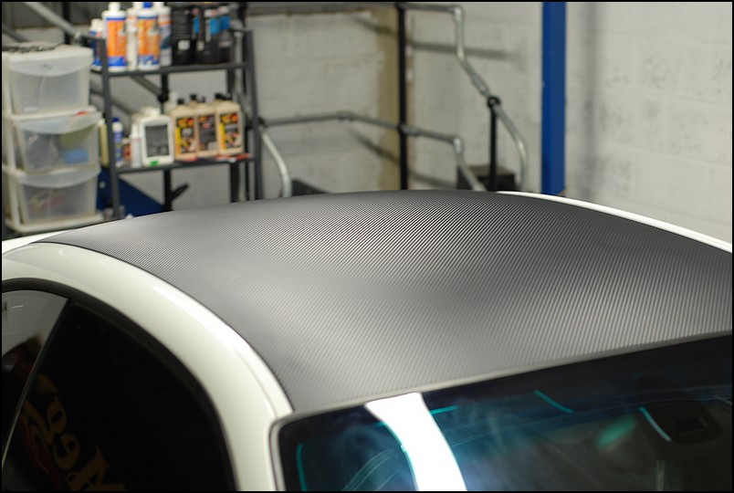

    Ok, its got to be said this is not real c/f but a 3m film that has the textured woven finish of c/f (huge debate about this on the car forum we posted the results on but hey, the customer is more than happy).
    This is an E46 BMW M3 one of only 10 UK cars that came in alpine white so finding a white one is very rare. The owner has also fitted a number of real carbon fiber parts so the challenge was to find a product that gave him a roof to match. In this case we didn’t go for a printed c/f but sourced 2 meters of 3M to do the job. In reality we had enough left to do some other ancillary parts for him such as mirror caps etc.
    Lovely finish to this film but its kinda cost prohibitive for us to buy even a half roll.
    Someone did mention we had just created a Mk1 Cortina vinyl roof and I had to agree with them!! 😀

    I like it, it looks the part so can’t complain there
    I’m very tempted to buy some for doing the roof of my mini but not sure yet as I know I’ll mess it up first time :lol1:
  • Graeme Clark
    June 12, 2009 at 11:53 am
    quote John Wilson:
    Its actually quite a thick film so has a lot of "give" in it John, you might be surprised!! and if you can get away with just a meter of it then all the better (from memory the film is 1.2 wide)
  • Joseph Helm
    June 12, 2009 at 2:32 pm
    Great looking job!
    I’ve been looking at doing some to my car.. might try and have a go at it after seeing that!

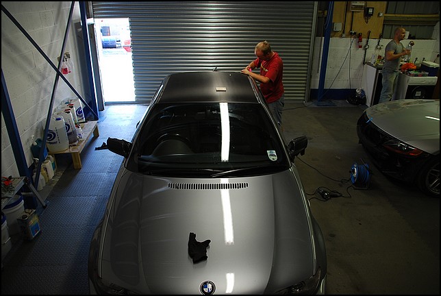

    Hi Adam, Yes its a very good alternative, not as thick as the 3m but we have got some pleasing results with it all the same. Cost wise its great and we are now using it in preference to the £m which was always limited in its supply to us for some reason.
    I have attached a pic of it so you can see the finish:
  • Alex Tucker
    July 9, 2009 at 11:08 am
    nice job Graeme.
  • Graeme Clark
    July 9, 2009 at 11:17 am
    quote Alex Tucker:
    nice job Graeme.
    Thanks Alex – the customer was very happy and we ended up wrapping his BMW Motorcycle Panniers and topbox in the same material for him so he’s got gucci matching luggage LOL !!
