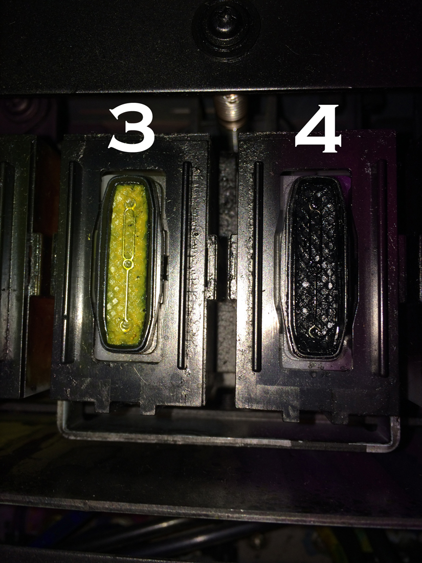

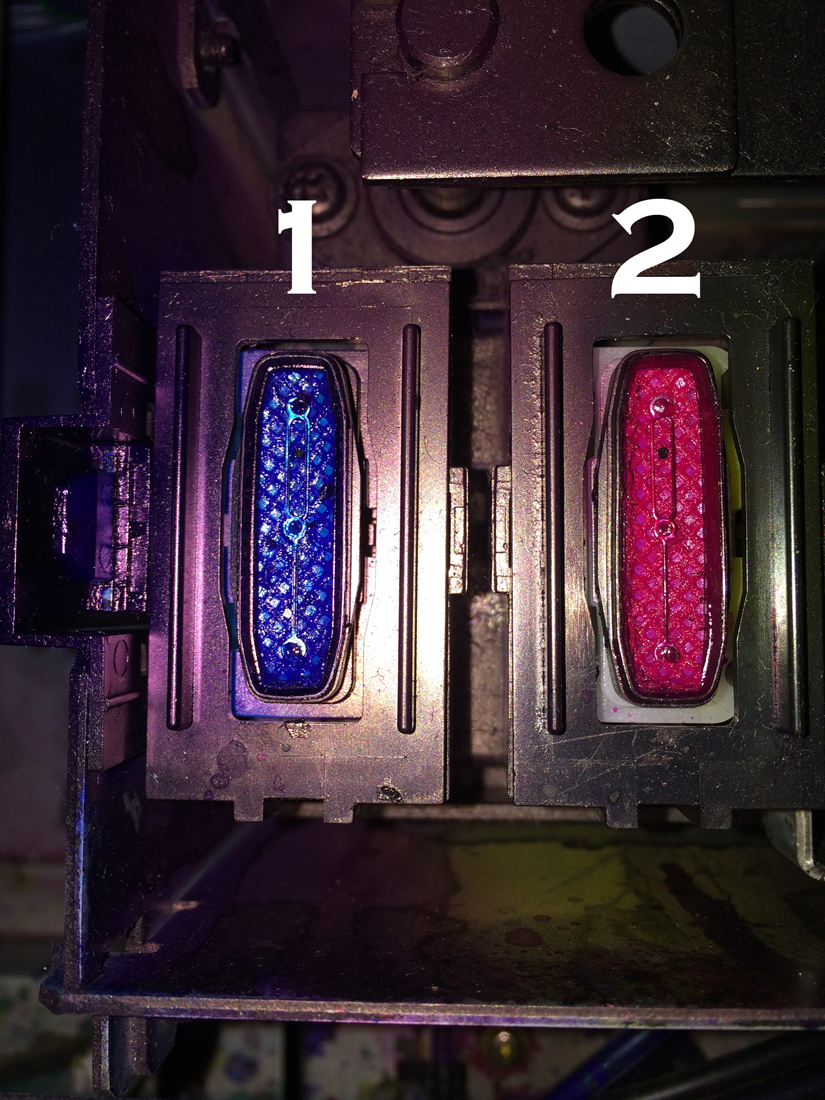

    hi guys sorry a few posts going up but troubleshooting my probs with xc 540 pro111 as some banding on yellows greens and blues, in your opinions do any of these need replacing and are they easy to replace? any videos around on how etc,? regards and thank u all in advance.

    hard to tell from pics but lot of ink everywhere you are looking for any nicks in the rubber seal. You can do a vac test on them by having heads in place then remove pipe from pump and fit syringe. If you get ink drawn through the cap is sealing ok, you can adjust the height of the caps until they seal. I believe i still have manual for earlier version SC545 which your machine is basically with some modifications.Hope this helps
