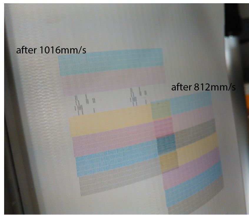

    hi
    as showing on the photo , all settings are same but the head speed
    if test print after each print, the result is like the second photo ,
    the black ink nearly doesnt fire at all.
    after few power cleaning and leave around 2hrs, it is back to normal so we change the black damper , now black is fine in any head speed ,
    But , same thing happen in light black now.
    any idea why ?
    thanks
    vs-i printer

    That does sound characteristic of a damper fault. If the K damper has failed it’s likely to be because the filter is blocked or the o ring is split or stretched. That being the case, it’s just as likely the others are going the same way.
    Stafford
