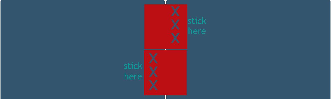

    Shane I would butt the panels together, but glue a pieces of dibond on the back one on each panel so they keep the joint together, or alternativley use panel locks, I presume there is a void behind the panel?

    Not sure what you mean by a panel lock mate, but after giving this more thought, I am thinking of getting the frames built to the same size as the diabond, with an upright every 2m, so I can butt them fairly easily just by boltling the frames together.
    I was not keen on the overlap idea as the joins will be obvious because of the thickness of the dibond sheets.
    There will be a void of 2m between the uprights. Will this be a problem do you think? or should I go with uprights every metre?
