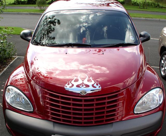

    Hi Darryl,
    Hexis do a 5 year 50 micron cast chrome, I’ve used it over the bonnet of a Chrysler PT Cruiser with very good results (see picture) – if memory serves it’s CH8001 (sad I know 😮 ).
    I think I’ve still got some kicking around if you want a bit to play with – let me know.
    Mark
  • signworxs
    November 9, 2004 at 10:15 pm
    OT…… nice flames mark.
