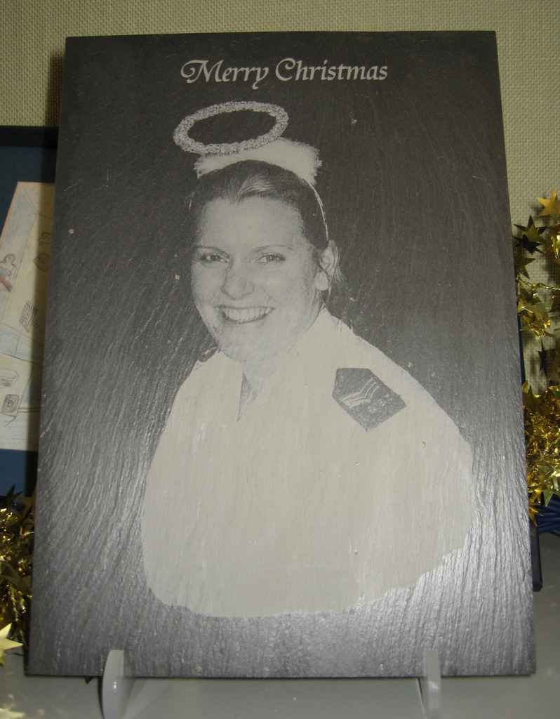

    Laser engraved slate gives an extremely good result in my opinion. Pictures can be engraved which are very sharp and detailed. One of the issues against it is that it is only ‘etched’ on and keeping the brightness of the image becomes a problem once it has been handled a lot. Even applying any type of varnish will dull the image substantially.
    This one is on slate and a lot better than the photograph actually portrays, but no one had been handling it and so no grease on the picture, also it is untreated here.
