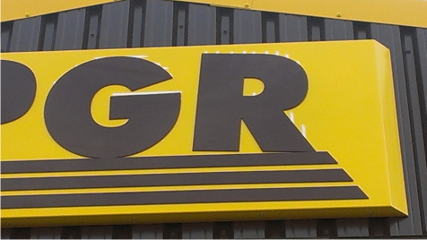

    We did an aluminium tray a few weeks ago that’s powder coated and had some 5mm acrylic letters made and supplied by a company that won’t be named. The backs of the letters have strips of VHB tape applied and the letters themselves are approx 650mm high. Now the sign is 25 ft off the ground and as I drove past tonight, the letters have slipped at least 3 inches and look ready to fall. The VHB tape is still on the tray and it seems it’s slipped off the acrylic letters. Have they used the wrong tape or is it down to the weight. My problem is I can’t get up there without a scissor lift to take the sign down, but need a fast fix tomorrow incase the letters fall as its above the main entrance. Has anyone ever used pink grip or similar to bond acrylic to a powder coated tray. Also are the acrylic letter suppliers responsible?

    I’ll definitely be on the phone when they open. Just aggro I could do without. I reckon they haven’t used the right tape. Although there was quite a bit on it, it was only probably 12 mm. Given the weight of the acrylic it probably needed to be at least 25mm strips. It could be the case that the tape has split as its only foam tape and the back of the letters also have tape still stuck to them. Either way it can’t be down to us surely. Just it doesn’t look good in front of the customer who is just about to order another big sign. What would you suggest to bond acrylic letters to Ali trays other than tape just incase?

    We purchased the letters with the tape already applied, but we applied the acrylic to the tray. I don’t even know if it’s 3M. It looks as if the tape has failed ie ripped down the middle, as the adhesive to both sides is still on the acrylic and tray. It’s the foam part that’s perished. Never had this problem before. I can only think there wasn’t enough tape on the backs and the weight of the acrylic is too much.
    Seems strange that they haven’t fell though, just slipped down

    after looking this morning, the acrylic has slipped off the tape by the looks of it, so maybe you are right rob, have they used the wrong tape? there doesnt seem to be enough behind it to me. could that be a factor? also would the heat from the sun do this? or the rain? surely vhb tape can perform in heat and wet weather otherwise whats the point. ive used this company a few times with bonded letters and never before has this happened. im worried all the rest of the letters on the building will fail now.
    would you say this is down to them?
  • TonyDwyer
    August 1, 2012 at 6:47 am
    strange thing is getting up there this morning, they are still stuck pretty well even though they have slipped, which is making me think its to do with the climate. is the tape going soft with the sun hitting the acrylic? would a 3m tape perish in the weather in 3 weeks with the expansion and contraction of the letters?

    well, it looks like most of the other letters are failing aswell. although smaller the tape is coming away from the acrylic. have spoke to the manufacturer and basically he reckons its the heat from the sun thats perished the adhesive through expansion and contraction. his answer was he will send out some more tape.!!!!!!!
    we’ve just taken the sign down and have now got to clean all this mess up.
    not happy!!!

    well it looks as if the adhesive on the tape has just simply melted away from the foam centre under the heat from the sun (not good) the supplier has blamed the tape supplier who in turn apparently said sorry!!!!!! thats alright then!!!
    the tape is made by or sold by titan tapes ive been told.
    however, im being sent some new tape and have got to apply to the acrylic myself.
    ive taken robs advice and scored the backs and also i was going to use an adhesive like CT1 or similar or is that a waste of time?
    because they are being bonded to a powder coated aluminium tray should i also score the tray itself for both the tape and CT1?
    the letters are 565mm high so is there a preference to which way i should run the tape. common sense is telling me to run the tape in vertical strips
