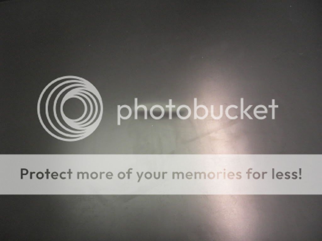

  • Shaun Harris
    September 24, 2009 at 11:29 am
    Here are some pictures of the bumps/bulges in the magnetic
    [/img]
  • Gavin MacMillan
    September 24, 2009 at 12:14 pm
    Never seen that before but may be worth sticking the to a heater to soften them up a bit and see if it has any effect.
  • Craig Brown
    September 24, 2009 at 1:47 pm
    That looks like a pressure mark…how is the customer storing the material when not on the vehicle?
