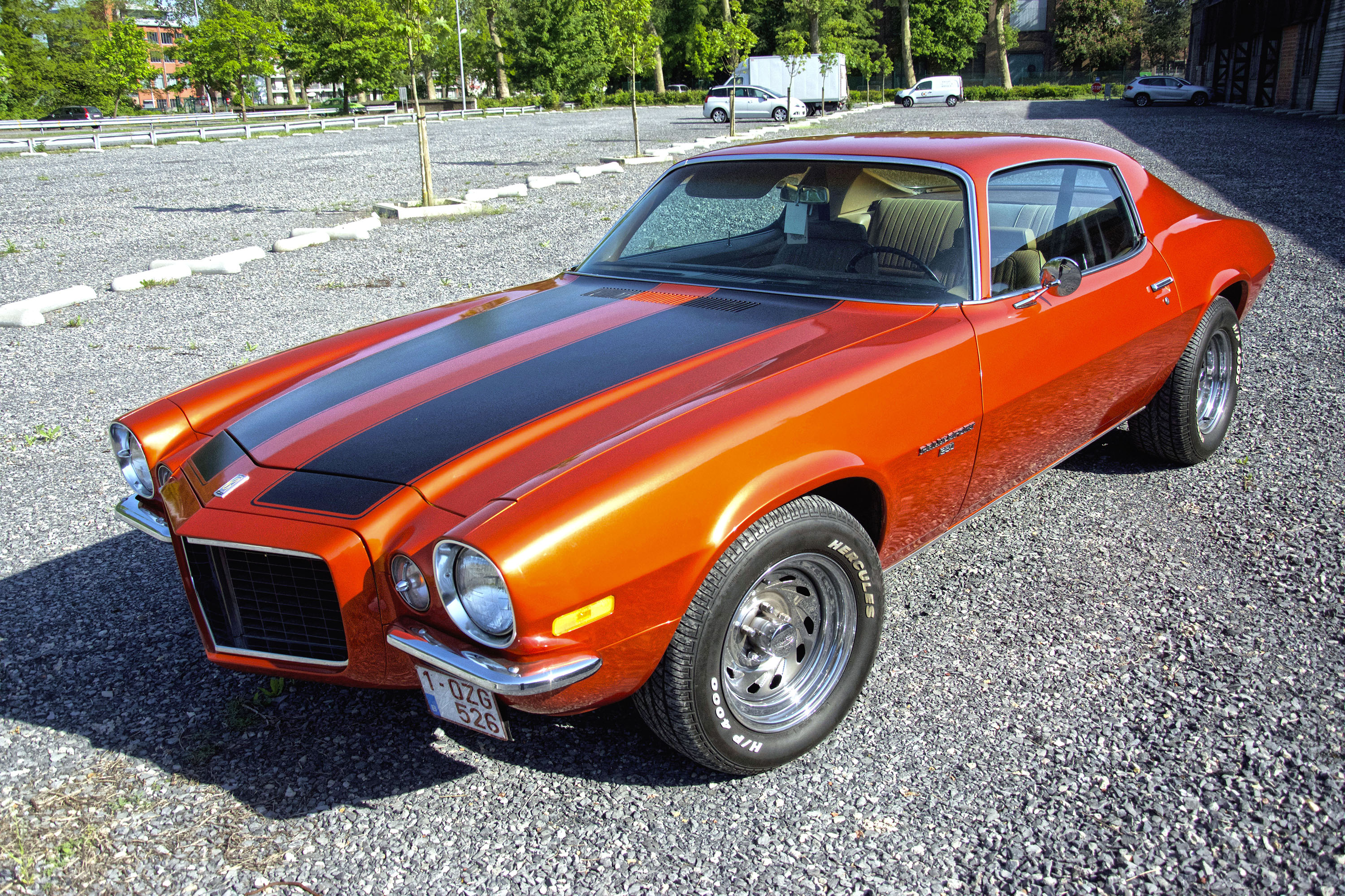

    Last week I did a colourchange from yellow to gloss fiery orange from 3M.
    Yellow as standard colour was not really helpful, I had to wrap more than needed to blockout all the yellow!
    Complete back was done in one piece, also the front part with the headlight contours was done in one piece…
    The difficulty was that the existing black striping was sprayed over the yellow base colour and was really thick, so wrapping over it was not an option and everything had to be cut out with the knifeless tape.
    The sharp corners is a no go with knifeless tape, even with the designline, so this had to been cut by hand 🙂

    Thx for the comments, wrapping itself did took around 40 hours…
