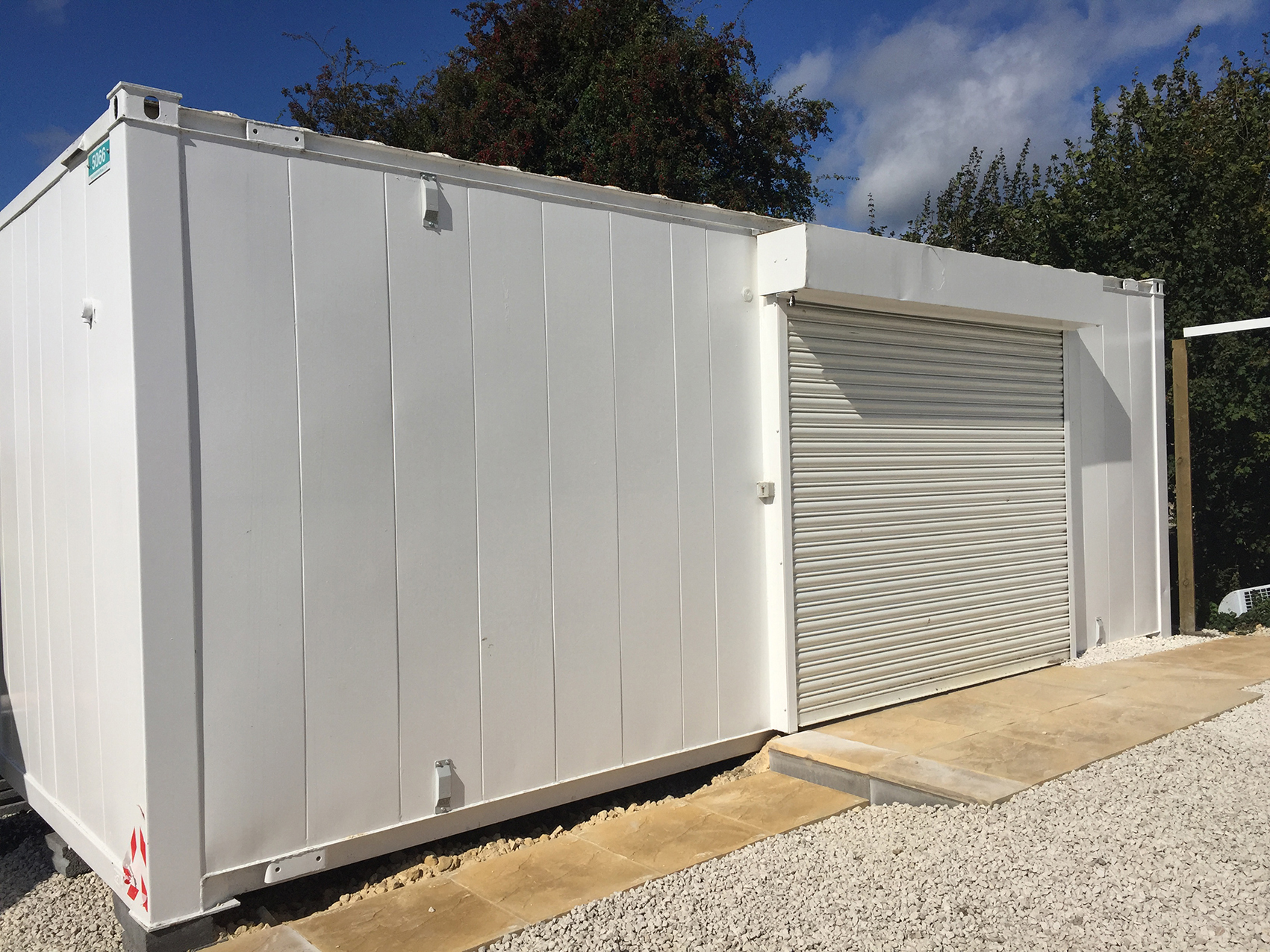

    We have been tasked with branding the cabin in the attached picture for a housing developer, we are not the design lead on this, just the sign production and installation.
    The designers want to do full colour printed graphics to fill the panels either side of the roller shutter doors. The cabin is made from steel and is rented, so I cannot see how we could really drill into this to mount either boards direct or any batons etc.
    The roller shutter casing will have a tray over installed to hide that to some degree.
    So anyone have any ideas on how we could achieve what is required?

    Can you not just apply vinyl direct to the cabin or tape panels to it?

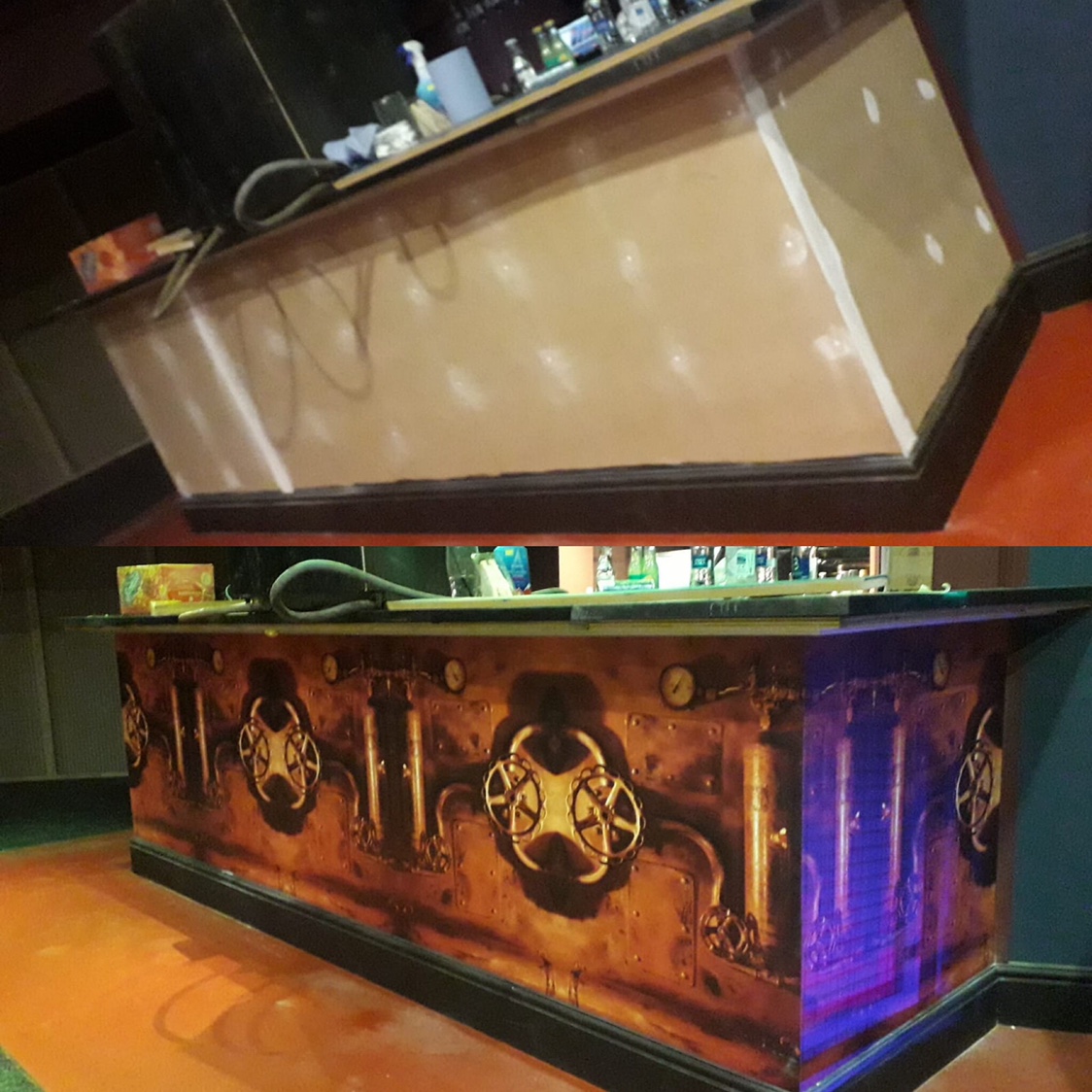

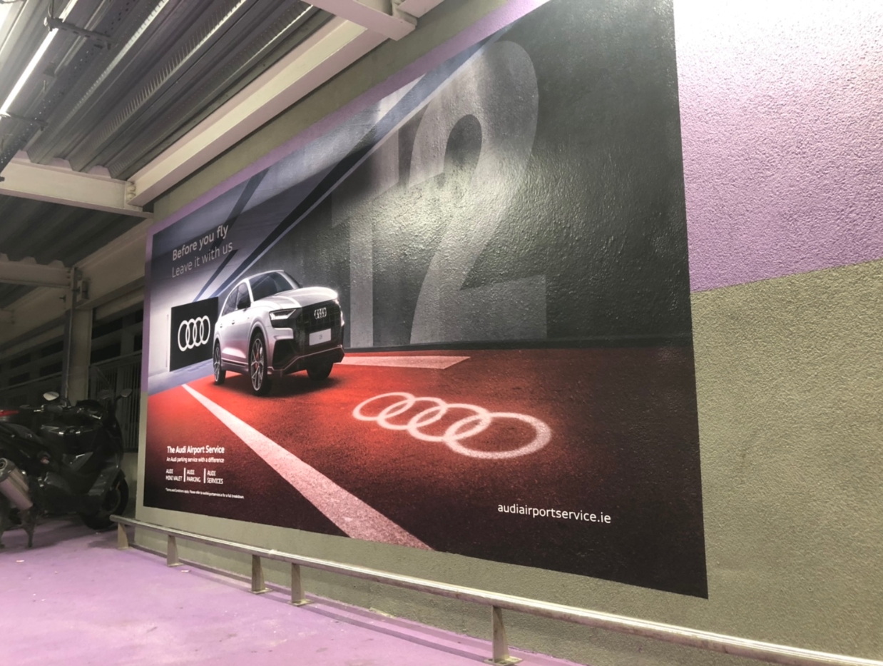

    What about this stuff. Sticks great but removable if needed.

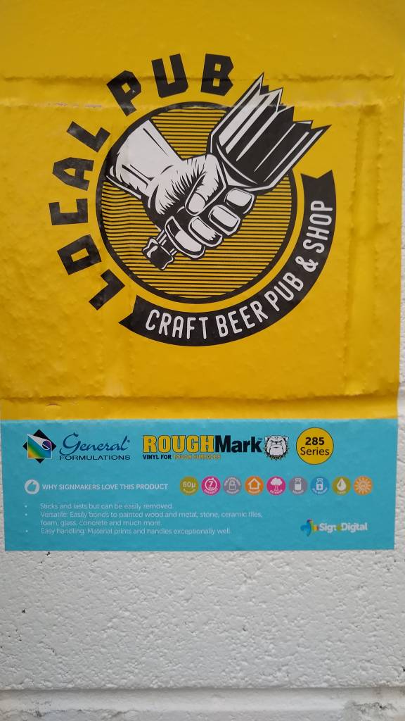

    Hi, try this now. The materials called "Roughmark" we’ve used quite a bit of it now.

    I can recommend the Rough Mark as well very easy to use apply straight from printer. I would say the lesser Sublink vinyl would do that container it is flat.

    Rough mark also for me!

    Looking at the pictures of the Rough Mark. That looks like it may have a sort of satin sheen also?
