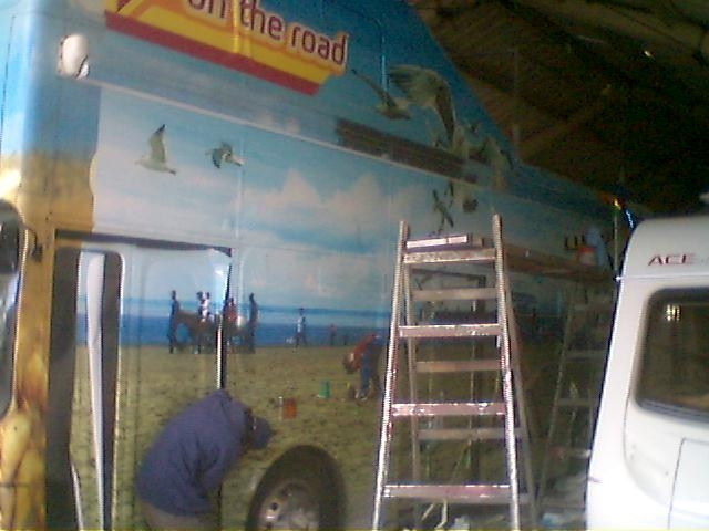

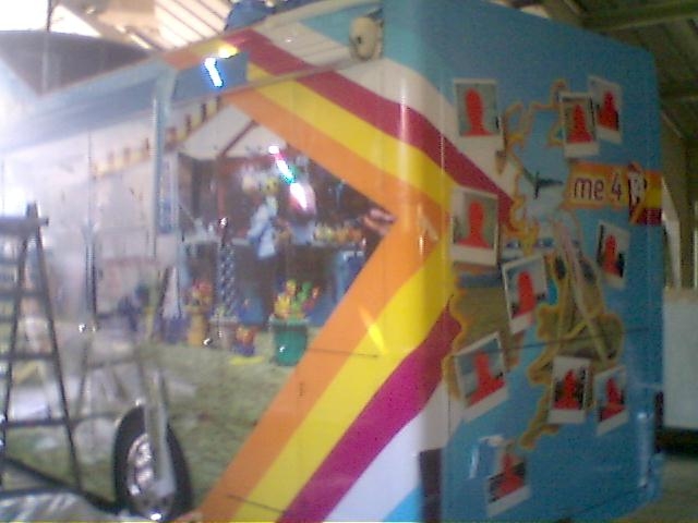

    four of us completed that job at 11.45pm last night, we started about 10am.
    As for where to start this one was a bit tricky as we had stripes running round all 4 corners, so we started on the back end and worked forward down both sides knowing that if we ran marginly out of line we could always juggle the front cos we had to cut a big chunk out where the windscreen is. Phil

    The designs are usually by a design agency but as regards to sizing & printing & tiling etc., to make sure everything works together we usually take the design to pieces as much as we can and then rebuild it, designers are ok but I do wonder if they have ever seen a bus, lorry or van closer than 30′ away or on a comp screen. It’s one thing to design a wrap on a 2d screen but it’s a completly different ball game to get it to work on a 3d vehicle.

    Yes your quite right on these promotional bus wraps – which you have to remember they only have to look good for about three months average- we just stretch over and blow in, on longer term buses we’d slit down each panel join as well. the other point on a longer term wrap is that we would use a better quality material.
    two big hassles with this type of work
    1 EVERYTHING is last minute, we got final artwork for the next bbc bus 4pm yesterday – has to be on the road first thing monday – no panic there then.
    2 finding somewhere to physically get the vehicle inside / undercover,
    we’ve done the last 2 or 3 in a barn of all places, all straw & dust just as all the manufacturers recommend.
