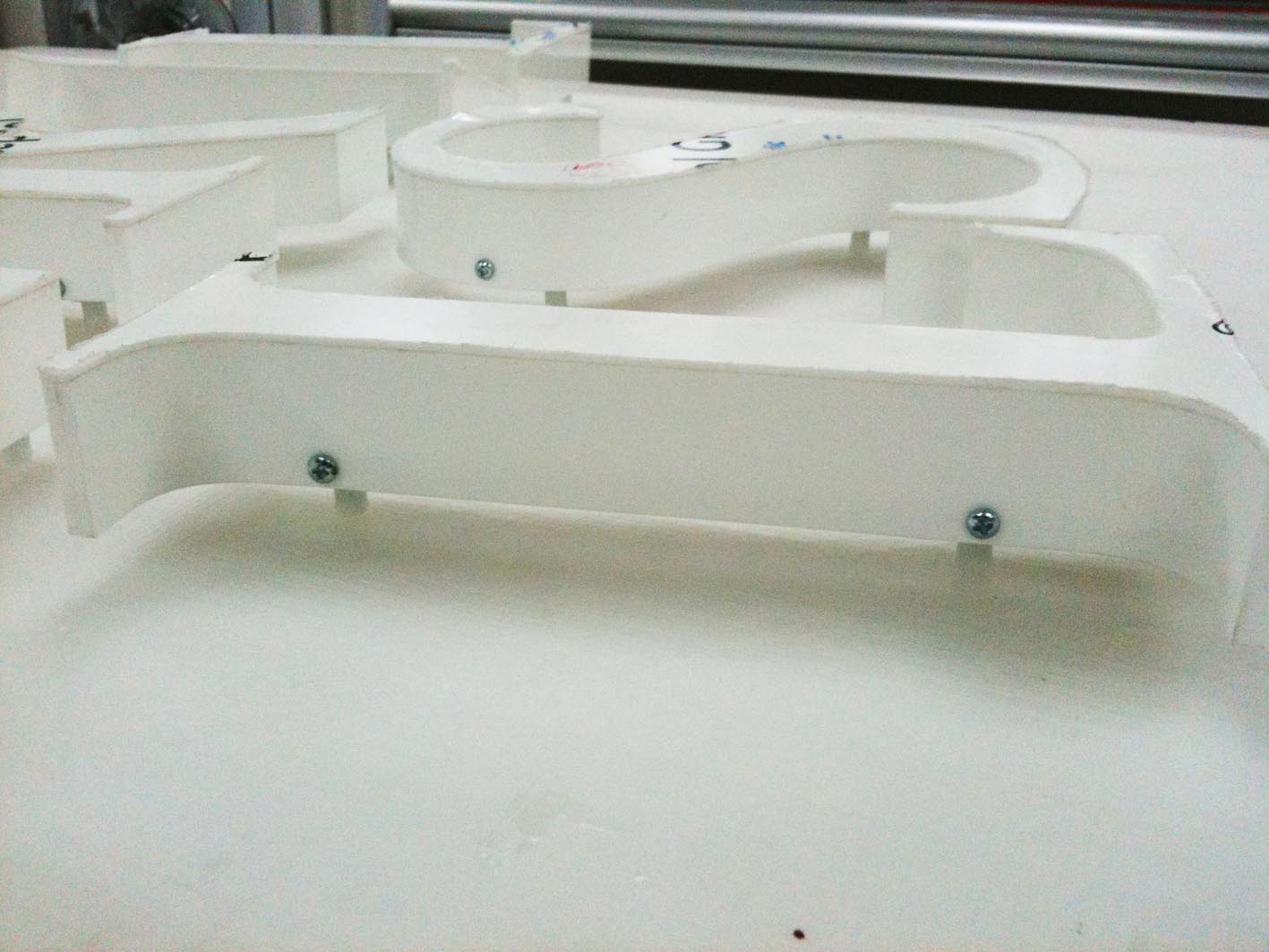

    Hi all, I ordered some built up lettering which has been delivered this morning & upon opening this is what i found. Have you ever seen screws into the sides of acrylic lettering before? Would you except it?

    what are the screws holding in? 😮

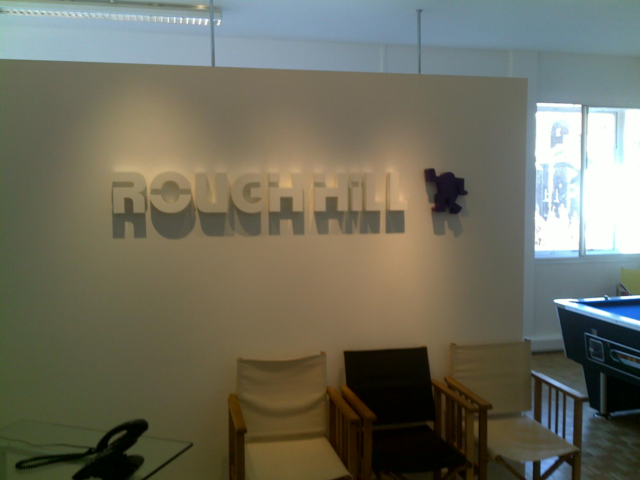

    Oh my GOD thats very poor. I would in no way fit these please see attached I fitted these some weeks ago and the lettering was made to a very high standard, made by GDI Signs

    The screws are holding in a 10mm Foamex backplate. To say i’m pi$$ed off is a bit of an understatement. I was expecting to see no fixings whatsoever.

    My letters were on stand offs and they had pillars built on the inside of the lettering to support the locator as you can see they look great.

    I hope they were as cheap as they look. There is no way Id ever put those up for a customer. There is absolutely no need for visible fixings with todays adhesives………….Id say it was pure laziness, or complete inexperience.

    my thoughts here are, IF they really need to use the method they have, whats wrong with counter sunk white or painted white screws?
    anyway….
    If there is a foamex backing plate, i’d assume these letters will be illuminated "front facing" using LED’s. ?
    this being the case, you will fit the backing plate like a regular flat-cut letter and wire it in through the back board/fascia to illuminate using LED’s fixed to the face of the flat-cut letter/backing plate.
    You will then fix the built-up letter to the "now mounted" flat-cut backing letter holding the LED’s.
    How would you imagine the built-up letter would be fitted to the backing plate in such a fashion that would allow access in future for maintenance/cleaning?

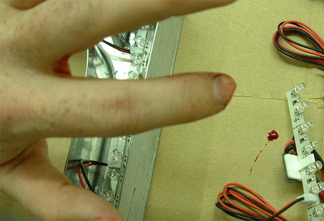

    We just designed the sign work, fitted the LED’s and installed the signage on site. There was two of these fascia signs for the same shop as it was on a corner. we also did glass etch work and small signage inside.
    We did not fabricate the stainless letters though… I did this one about 5 years ago Graeme, but i do not remember the supplier of the built-up letters. sorry…
    LED’s were from ashby though… i remember that because i cut the end of my index finger with heavy snips trimming the LED strips. 😳 :lol1:

    are the letters to be front-illuminated from the inside?
    not trying to be funny kev, but "from the pictures" other than the screws not being counter sunk, in white and positioned a little more discretely. the actual fabrication looks pretty good.
    anyway, this is why i asked the question, put to anyone really… how would we expect the letters to be attached in a convenient way to allow access at a later stage?

    I have to agree with Rob, Why back trays & stand offs, If non-illuminated/ external lighting?
    Did they confirm what they were going to do for you?
    As a trade supplier we always try to send confirmation when items are ordered, stating construction & materials where possible, we have had on occasion customers not actually realizing what they are actually ordering or what they ordered was not what they wanted!
    In this case, it appears that PVC locators & internal bridges would have been sufficient leaving no fixings showing.

    those letters with a foam backtray in would usually be used with internal lighting which is why you use screws through the side – problem is you do it discreatly with small countersunk colour coded screws placed accordingly – it is the correct way to do it for letters that you need to get inside off – for letters that you dont need to get inside of then you block them up inside and glue on a locator – those were shocking !!!

    this is my point though…
    other than the screws not being white countersunk, the job looks like a good one to me, yet it is being shot down as poor, but nobodies saying why or how it should have been done? (for an internally lit built-up, because this is what it has been made for, although i accept kev saying he wanted non-illuminated)
    the acrylic used also looks like its translucent/opal as opposed to dense white, which would again indicate the job has been created for internal illumination. (going by pictures on this of course)
    so my view on this is that it IS a good job with the acceptation of no white countersunk screws.
    as i said, this would have taken them longer to make and would have been a more expensive method. so their quote would also have been more expensive also.

    ouch!! that looks painful rob!! (!)
