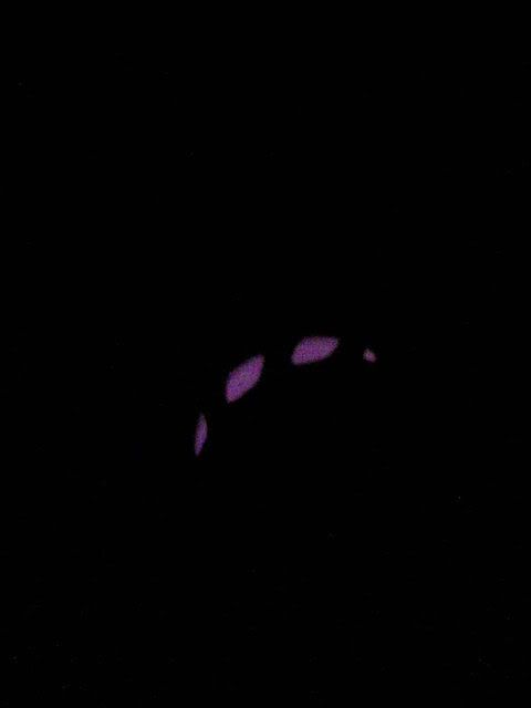

Well, it might be worth a try, but I know they get hot.
Terrible picture I know, but this was my disc glowing through my wheel after a spirited drive home once 😳
Needless to say, the calliper would have been pretty warm too :lol1:

The caliper is insulated from the disc and usually from the pads as well.
You’ll usually find a insulating pad on the piston face, you don’t want the caliper any-were near the temp of the disc as the brake fluid would degrade.
They can get to boiling temp though and this is why you need to change your fluid regularly, so you get rid of the water as well which can boil and lock your brakes on.Steve
Mine of useless info -
Yes, but the radiation of heat from the disc will be more than enough to heat the calliper to a few hundred degrees (albeit briefly) Also the transfer of heat from the pads & discs whilst breaking will be enough to heat the calliper to a heat you wouldn’t want to put your pinkies on :lol1:
I worked as a mechanic when I was younger & remember a car coming in with partially seized brakes. We couldn’t get near them for ages & when we did I remember being surprised at how quickly the heat got into my socket ratchet whilst undoing the calliper bolts 😮
Was nice though, as it was a cold day!
