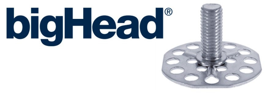

    you mention small letters, but if large, I have in the past used bighead fixings on brick walls to get a better-hidden fix.
    https://www.bighead.co.uk
