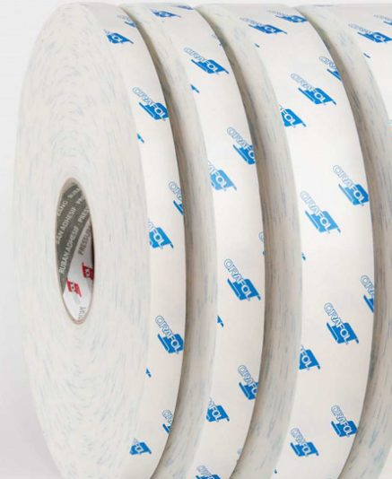

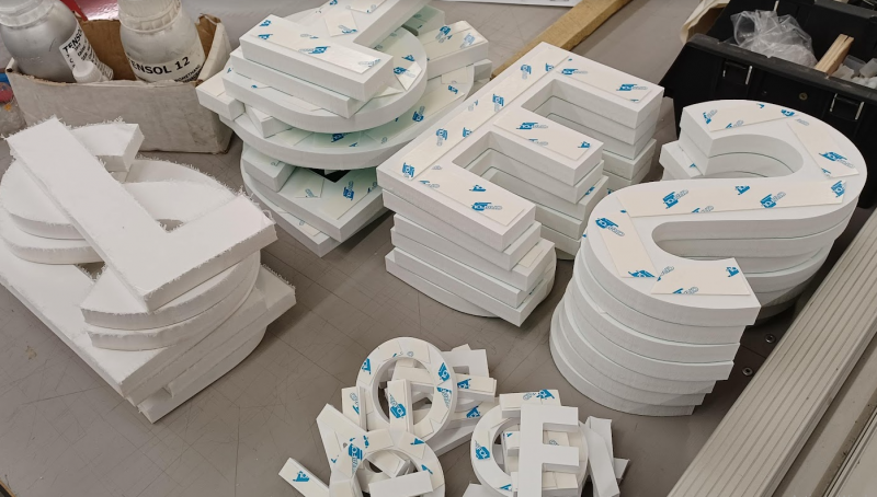

    Hi Darren
    We use Oracal Foam Stick tape. You can buy it from Vink. I use “Vink Scotland” which was formally Europoint.
    Don’t get it confused with the likes of the thin oracal banner hemming tape. You want the “foam” tape, it’s about 1mm thick x 25mm wide.

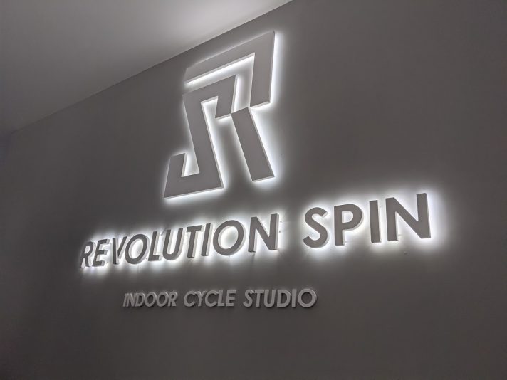

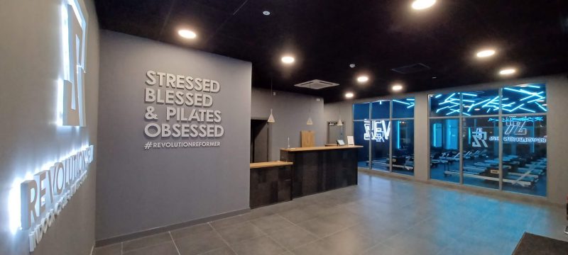

    All the non-illuminated letters in the photos are done using this tape.

      Perfect! Thanks Robert. I will give that a go.

          Fantastic service from Vink Scotland – I had previously called around all the usual suspects for supply of some tape to do the job and not one of them had any notion of what to supply. The lass at Vink Scotland was superb. Had great knowledge and the delivery arrived next day. I tested some and by eck, it’s on!
          Thanks Robert for the steer.

      I forgot to add that the test piece stuck like you know what to a blanket. Awesome stuff!

    I have used double sided foam stick for years, excellent tape.
