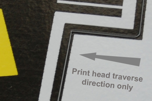

    I’ve got a slight problem with the black ink printing on my BN-20.
    See attached photo.
    It’s only happening in one direction, across the print head travel. Not in the roll feed direction.
    I can see corresponding ‘dry’ lines in blocks of black to the tiny lines of black that appear on the edges.
    This isn’t the same problem that I had before (hair/fluff on the bottom of the print head).
    Black ink cartridge replacement is very soon.
    Thanks for any help.
    Chris

  • Neil Somers
    August 9, 2016 at 4:24 pm
    Chris,
    The problem to me looks the same in both pictures, it just looks a lot less pronounced in your first picture.
    I know you said it is not but it could be somethig tiny on the print head.
  • Chris Jarvis
    August 9, 2016 at 4:56 pm
    quote Neil Somers:
    Chris,
    Thanks Neil,
    Ignore the second photo.
    It has nothing at all to do with the problem I have at the moment.
    It’s just there to illustrate a previous problem, and how the symptoms are significantly different to the problem I’ve got now (shown in the first photograph with the grey arrow and lettering).
    The problem shown in the second photograph WAS caused by something physical stuck to the bottom of the print head and solved via advice gained from this forum).
    At the moment, there is nothing stuck to the bottom of the print head. It’s clean and is an even space from the media as it prints/traverses.
    Chris

  • Chris Jarvis
    August 17, 2016 at 5:28 pm
    Nozzle test looks like this, today 17th Aug.
    August 17, 2016 at 6:23 pm
