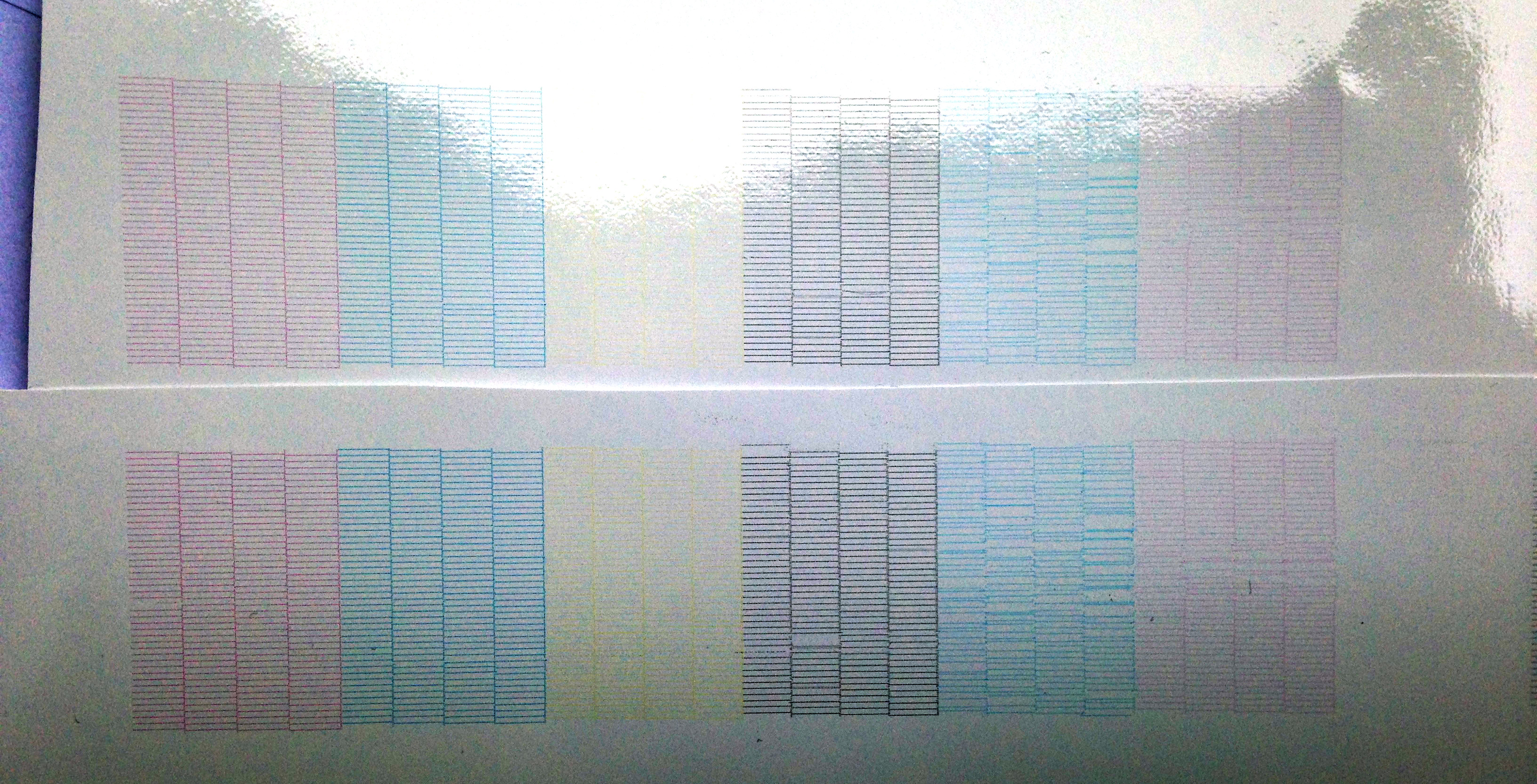

    Can you post a good quality picture of the test draw? It would be handy to see how it’s failing and what the colours next to it are like. Whose inks are you using?

  • Jon Miller
    January 27, 2016 at 1:57 pm
    A little tricky to get a decent shot with the phone but have attached a couple.

  • Stafford Cox
    January 27, 2016 at 2:50 pm
    They’re great, thanks.
    OK, it’s not looking great for the right side of the head at all. It could be that the right side of the pump is failing? What are you running in the other 2 channels? White or flush?
    My gut feeling is actually that the head has had a knock. The pattern you’re getting on the lm channel is looking like physical damage to the head. Just a hunch though, hopefully it’s not that. I would keep running nozzle washes and switching it off at the side over night and see if the pattern starts to recover. Otherwise, it would be worth getting a reputable engineer in to have a look, he can then try running channels in different orders, flushing head channels etc.

  • Jon Miller
    January 27, 2016 at 3:23 pm
    Running white / silver in the other two.
    Test prints haven’t been that bad with the light cyan before that I can remember and haven’t had any media strikes since last decent test pattern. I have had a couple minor ones in the past but were some time ago and has been printing ok since then.
    Slim chance of a dodgy ink cart perhaps? Although running the SM3 inks in the others ok and as mentioned, the issue with the black was apparent before making the switch from genuine inks.
    Who knows, maybe the SM3 inks have contributed to the deterioration of the head or the head was on the way out anyway being 5 years old and so just a coincidence.
    Maybe another part as you say..
    The test pattern is slightly better after numerous cleans/washes but the blue lines in the grey prints are still present.
    I will let it soak overnight and see. It is my only printer, besides the thermal, so needs fixing asap.
