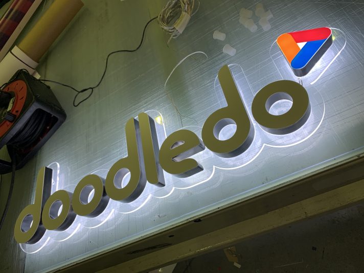

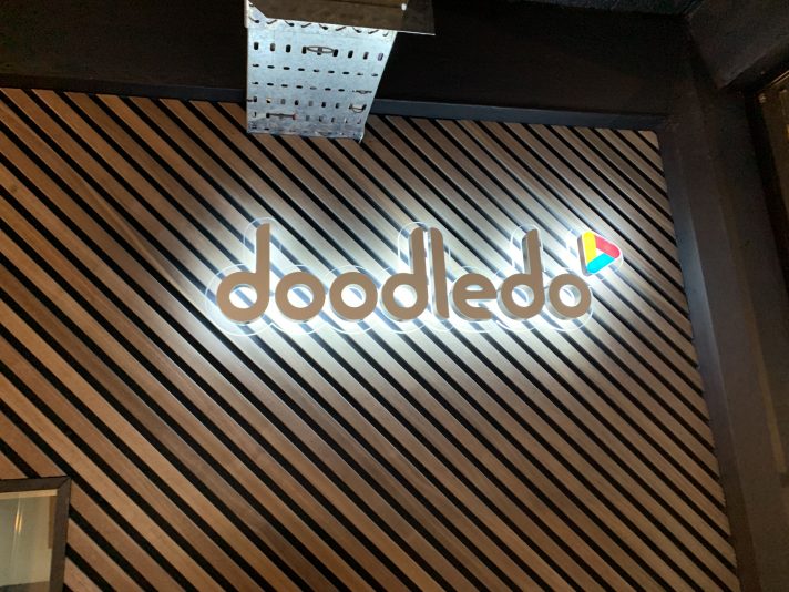

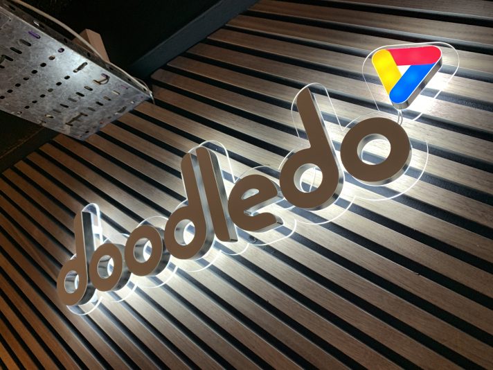

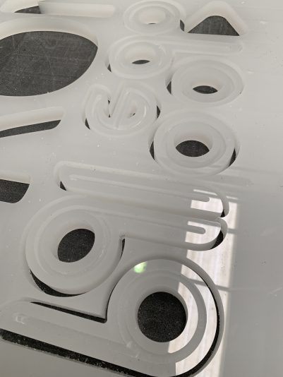

    We are making more and more of this style of letter but I particularly liked the look of this small sign due to how well it worked on the slatted timber background.
    First time using the mini acrylic block LED’s from Khalid at Citi-LED, thanks, much better than the edge lit side emitting ribbon we’ve used before. Note, in the real world there isn’t any light spotting on the coloured triangle element – I just cant take photos of illuminated signs without over exposure.
    Cheers Dave

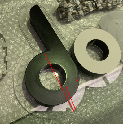

    is that just a block-out vinyl you have applied to the face? I’m guessing then cut composite or similar for the face? the reason I ask is the uneven impression has me lost. πŸ€”I’m a nosey sod, i know! 🀣

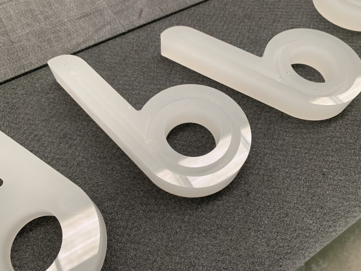

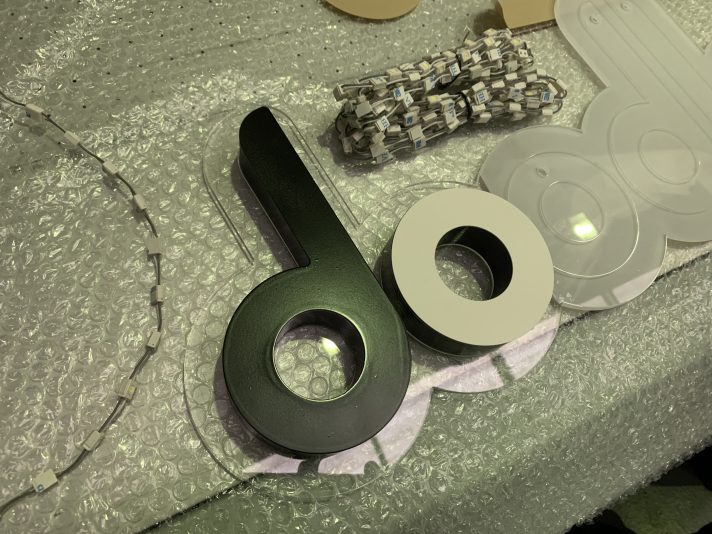

    We wet sprayed the letters front face/returns white to help reflect more of the light out the back of the letter and sprayed them black for a light block, it’s just a build up of paint. They wanted a non illuminated white face so 1mn white engraving laminate was bonded to the face to hide this.
    The halo worked better having the LEDs still facing into the block letter, rather than pointing to the rear – more diffused. The triangle logo face was left without any spray and printed translucent white vinyl.
