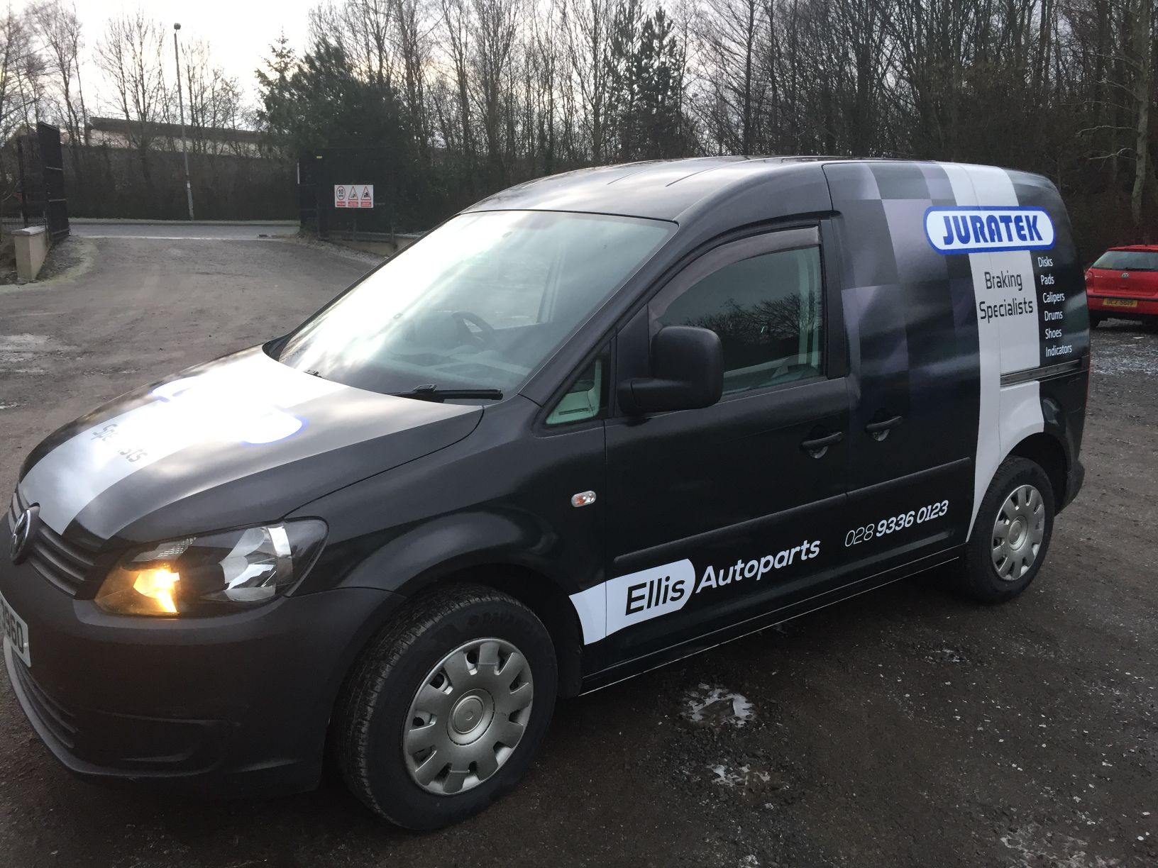

  • John McNickle
    May 28, 2019 at 8:49 am
    Sorry Luke id attached some but hadn’t noticed they were too big, here they are, you might notice the misspelling of Disks :shocked: but it was fixed just before it went out the door ๐Ÿ˜†
  • Luke Culpin
    May 28, 2019 at 7:44 pm
    Looks really well! Nice job!
  • Vince Brown
    May 29, 2019 at 6:54 am
    Job very well done I say! :claps:
    May 29, 2019 at 7:28 am
    quote John McNickle:
    Another good reason to apply vinyl on top of a wrap ๐Ÿ˜‰
    Nice job, did you remove the rear lights, and the plastic stop for the sliding door?
  • John McNickle
    May 29, 2019 at 7:44 am
    Cheers guys, we popped the lights out but just trimmed into the bump strip, they are on with D/S tape and loose shape etc when removed so they always look crappy refitted so the customer was happy to have them left in place
