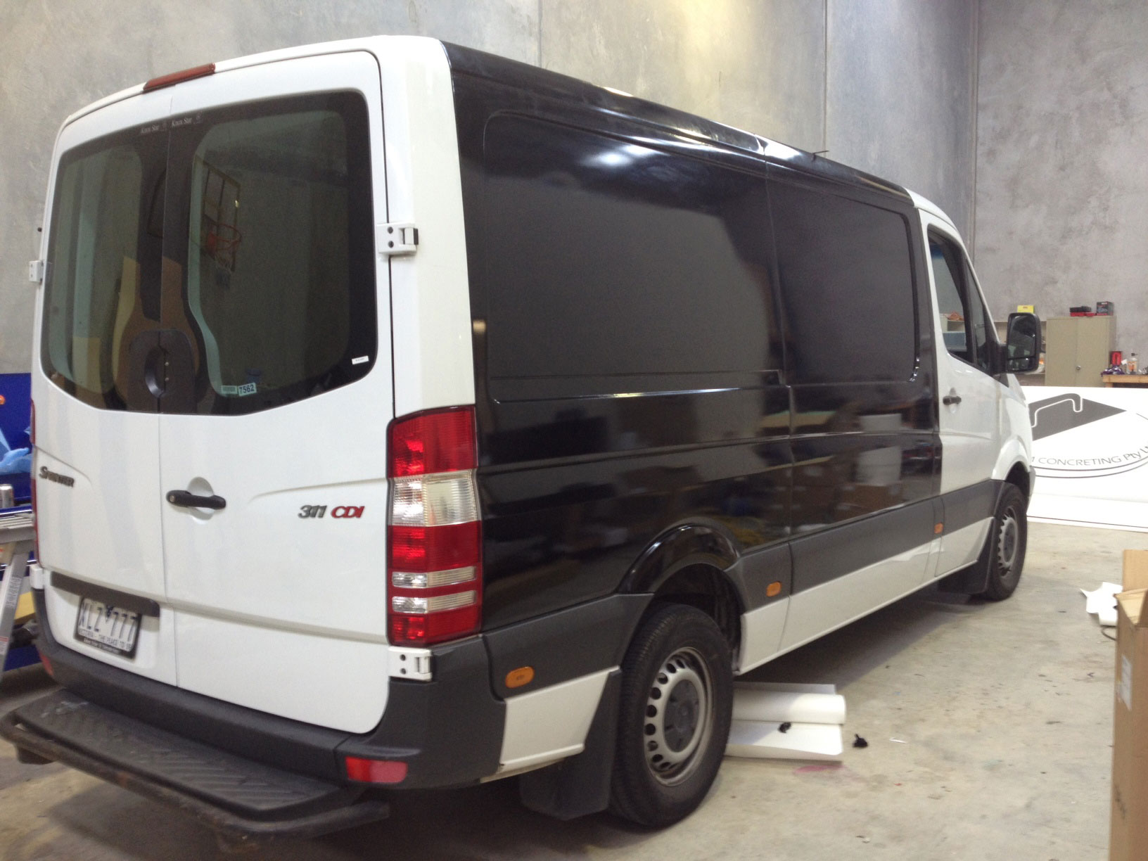

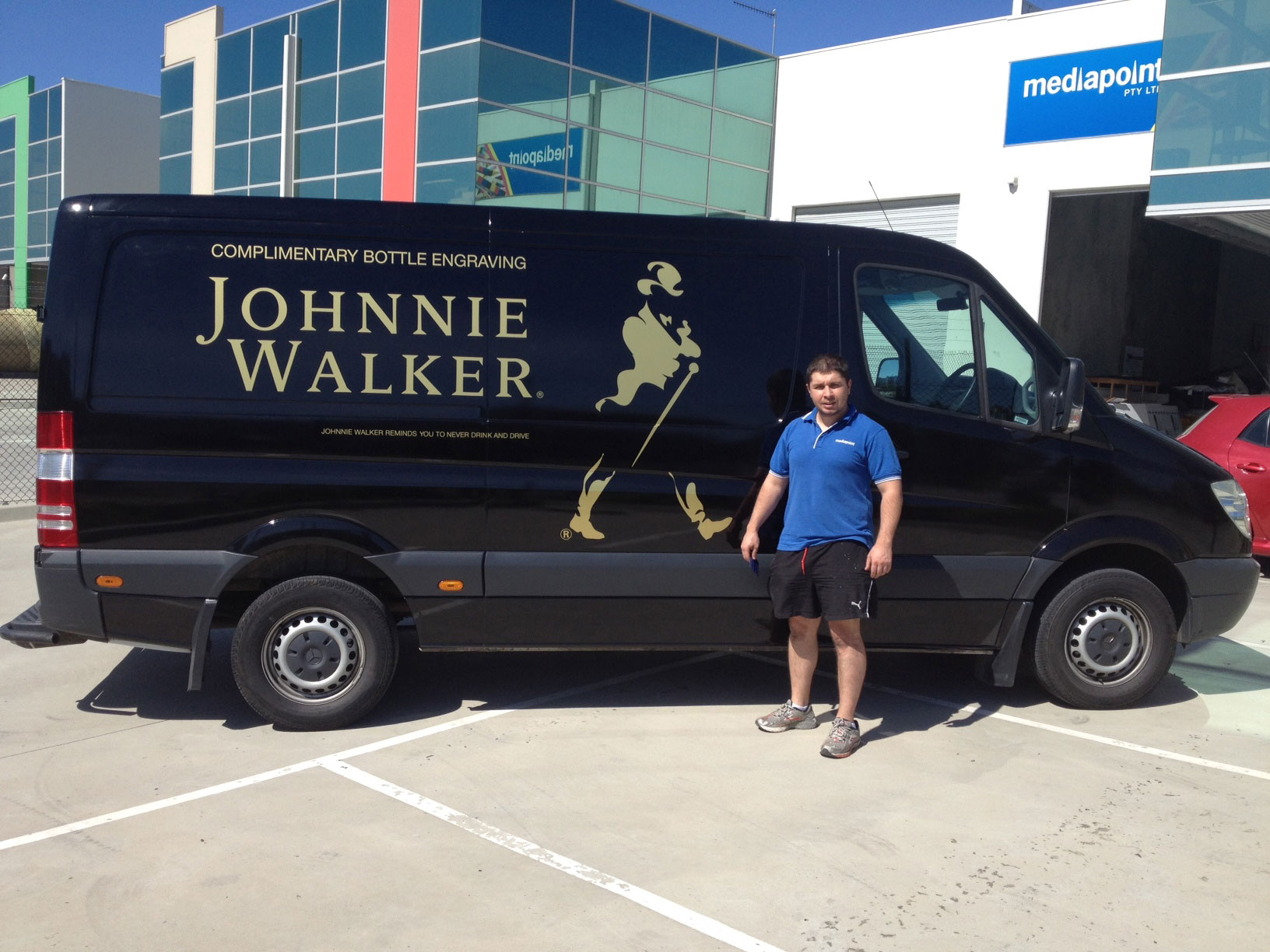

    Did this a month ago. Not matt black though gloss black.
    The roof took me the longest due to all the ribs and having to heat and post heat around them all.
    Being in an awkward position on the roof doesn’t help either but you are way lighter than me Cheryl so your safe.
    This was the Avery Supreme Wrapping Film. Awesome product removed without any heat either and no residue.
    December 29, 2011 at 12:04 pm
    good to hear some feedback on the avery supreme jason, van looks great too mate.
