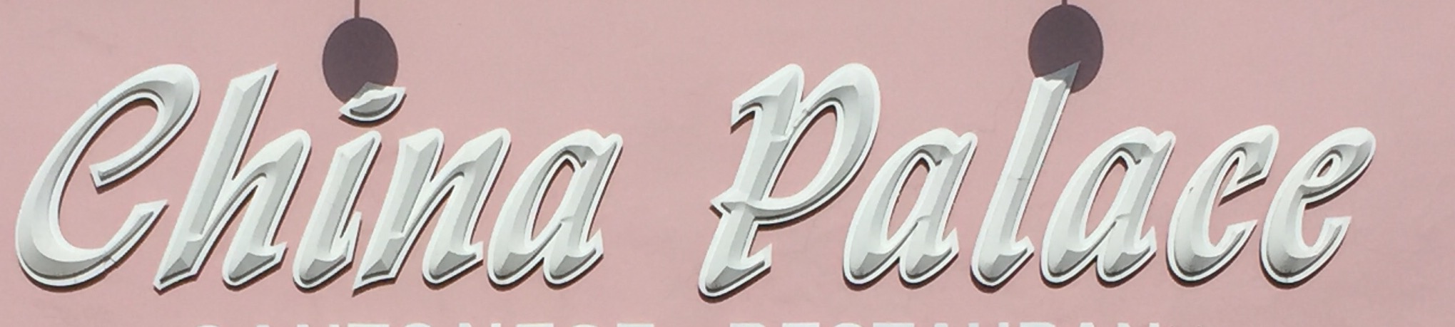

    Hi I have been asked to create a new sign for a restaurant and they want letters like the picture. From the ground they look like bevelled acrlic letters and are backed with foamex? I have tried my usual go to letter maker but it is not something they can do. Can anyone recomend another supplier, many thanks jean

    Accent signs should be able to do those Jean,
    Moulded letters on a foamex/ acrylic backing
    https://www.accent-signs.co.uk looks like their website is being updated but worth a call.
    another:…. http://www.bhma.co.uk/moulded-acrylic-l … ith-border

    We have done this before for a trade client…
    Done this type of style in MDF, Acrylic and Foamex
    April 14, 2017 at 9:29 am
    I think this style could be accomplished using a CNC router fitted with a V shaped cutting tool to create the bevelled edge
    April 14, 2017 at 4:19 pm
    quote Phill Fenton:
    You are quite correct Phill, Prismatic letters are easy enough to do on a CNC 😆 😆
  • KevinGaffney
    April 18, 2017 at 10:45 am
    Weve done a lot of this type of work on our cnc for many years. Only requirement is the right software and its dead easy
