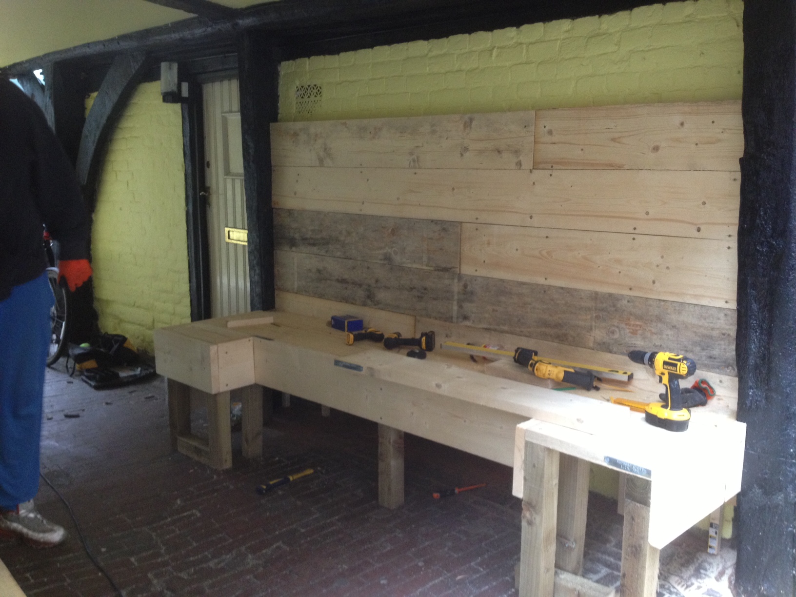

    Hi all customer needs a round printed logo applied to a wooden bench anyone have any suggestions at how to best approach this material wise please?

    Prep the bench (assuming it’s planed smooth) in clear polyurethane varnish then apply graphics…almost anything will stick as it’s effectively a sealed / painted surface.

    Thanks david and I assume if painted gloss colour the outcome would be the same?
    would you slice the graphic and remove the tiny sliver between planks or leave the graphic whole?

    if your using a good cast vinyl then just a slit inbetween the wood joins but if not a mm or 2 back.
    mind let paint/varnish cure or gass out first
