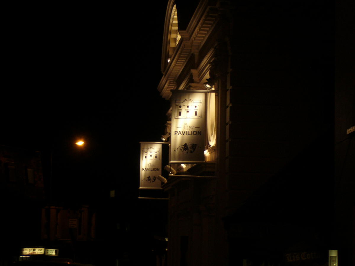

    finally i was able to finish this job today, i put up the brackets last week, then finished as the scaffold came down today,
    banner tensioning system and brackets were supplied by bannerbox,
    as were the double sided total block banners,
    artwork based on customers wishes, though i drew the theatre vector,
    would reccomend the banner system if you ever have to do this kind of work, nice and easy to install, i guess i spent less that 6hrs on site in total, though i think 4 would have sufficed with proper access,
    my only doubts on the banner brackets were the quality of the finish,
    i have yet to talk to bannerbox about it so wont make a big deal over it,
    basically it’s nothing major, the welding and all were fine, the order to delivery time was around 5 days… great !
    A) I just feel the painted finish could be muchly improved by perhaps powder coating, rather than using something like a hammerite spray, just normal handling chipped them and resulted in me getting some white smoothrite which was a perfect match !
    B) the other issue was the weld splatter inside the bracket pole, when sliding the pole into the rbeacket, the splatter made it a little difficult to get the pole in, and resulted in the pole getting scratched somewhat,
    other than that, great !!!
    decided against the chemical fix bolts in the end, opting for the biggest rawl bolt expanding bolts i could find, 21 x 100 mm! this baby aint fallin down !
    i’ve suggested to the manager tonight, about changin the lights on the banners for uplighting flood lights, these arent great, but i had no hand in them,

    November 23, 2005 at 8:12 pm
    night time

    Nice one Hugh, they look neat. I’ve got two of these to do next week so thanks for the warning about the paint finish, I’ll get some smootherite!
    What was the bigness (real word!) of these?
    November 23, 2005 at 8:37 pm
    lol ! the bigness was 1200 high x 600 wide, overall the height is about 5ft,
    i know this sounds obvious, but make sure the tensioners are opened to max before marking for the holes !! my major worry over this one was that i had to measure the banner system stretched out on the floor, and fit one bracket either side of the scaffold lift, then go back to day and pray i’d measured right !
    btw, theres nowt ya can do about the bottom pole pulling up on the outer end,
    November 23, 2005 at 8:59 pm
    they look good Hugh well done,
    I wouldn’t have noticed the thing with the bottom pole until you mentioned it 🙄 nice job

    Where they renovating or painting the building at the time you installed the signs? Just wondered if they erected the scaffolding for you to do the job specifically or they were killing two birds with one stone?
    When you say Rawl Bolts are you talking about anchor bolts?
    Nice work by the way – So you had to do a bit of vectorisation eh!

    Only minor crit, rawl bolts rather than stud would have been a bit nicerer (real word I dont think) finish.
    and nothing to do with you, Hugh, but I think the “modern” banners are a bit out of place on such a nice old building.

    Peter, dont you be burgliaring my words, nicerer is one of mine !! i used the studs cos i didnt really want to use bolts, a nicer finish agreed, but i had to use the studs as i couldnt find the bolt type locally anyways,
    i plan to return in around the new year to just check everything is still tight, at that point i’ve told the architect (proj manager) that i’m happy to trim them if he wants me too, he seems quite happy with it tho.
    John,
    anchor bolts ? always calledem rawl bolts cos thats the original maker to my knowledge, they’re the stud type that when you tighten the bolt, it pulls a wege into the metal sleeve and expands it.

    just me ! they’re pretty easy to fit if you can drill a hole ! each bracket has three holes (this is the std duty system),
    ordinarily…..
    mark the holes for the top bracket,
    drill and bolt on,
    fit top pole, tighten bolt and grub screw,
    hang banner with tensioning system fully open,
    mark holes for the bottom bracket while it’s hanging,
    making sure the bottom bar is level,
    get the banner outta yer way,
    drill and bolt on,
    slide the bottom pole in,
    tighten up pole bolt and grub screw,
    then simply adjust the tensioners and lock them off when you’re happy with it,
    some adjustment might be needed to get the banner hanging vertical twen top and bottom pole otherwise it appears to pull a crease into it,
    in this case i couldnt hang the banner and drill the botom bracket, so had to fit top pole, pull it tight and measure the drop, then go down to next level and measure down from the top bracket, quite nervy at this point ! thankfully it all worked out fine !
