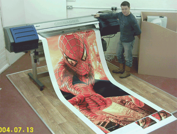

    well as some may know by now i now have my new solvent print & cut machine.
    we had the training for it on friday afternoon so have only just been playing with the settings & trying to become familure with it all..
    andrew (vectorwise) & i, that is.
    today, was the first day we started to actualy print work that had back-logged before we got our hands on it. from around midday, andrew had it working flat out without any glitches.. thank god.. sooo.. around 5.30pm we decided to run our largest single print… shown below.
    the rip took only 3 mins to send the message to the machine and the print took only 12 mins to print.. colours and print quality were amazing, this was onto “banner material”

    That is outstanding quality Rob 🙂
    Is it true that the machine is only 2 foot off the ground? :lol1: :lol1:

    12 minutes to print? Blimey that’s quick, aint it. Mind you, looking at that bloke stood next to it the print must be about, what, 2 foot long?

    with regards to the machine being only 2 foot and 2 feet long prints..
    well i am utterlly gutted, you both know fine well i stand 6’2″ in my socks.
    why oh why must you keep making fu of me because im so tall and lanky.

    But that is one heck of a machine, 12 mins wow!!! Impressive …..!!

    Exellent mate!!!! congratulations on the new machine….. now go and treat your self to a new pr of shoes :lol1: :lol1: :lol1: , i used to wear those rigger boots when i was a trucker, i needed them as i used to collect & deliver blood & animal offal, great for keeping the toes warm though 😉 eddie

    Hi Rob excellent print, We have just bought a Grnadier expecting deliver end of the month, after seeing what yours printed i cant wait!!
    I don’t mean to be cheaky 😳 but is there any chance of getting that spider man picture for our display room? or even any information on where i can get that kind of high quality art work?

    That is a sweet looking print indeed, Robert! CONGRATS!

    lookin good rob.
    are you allowed on that laminate floor in those dirty old boots?
