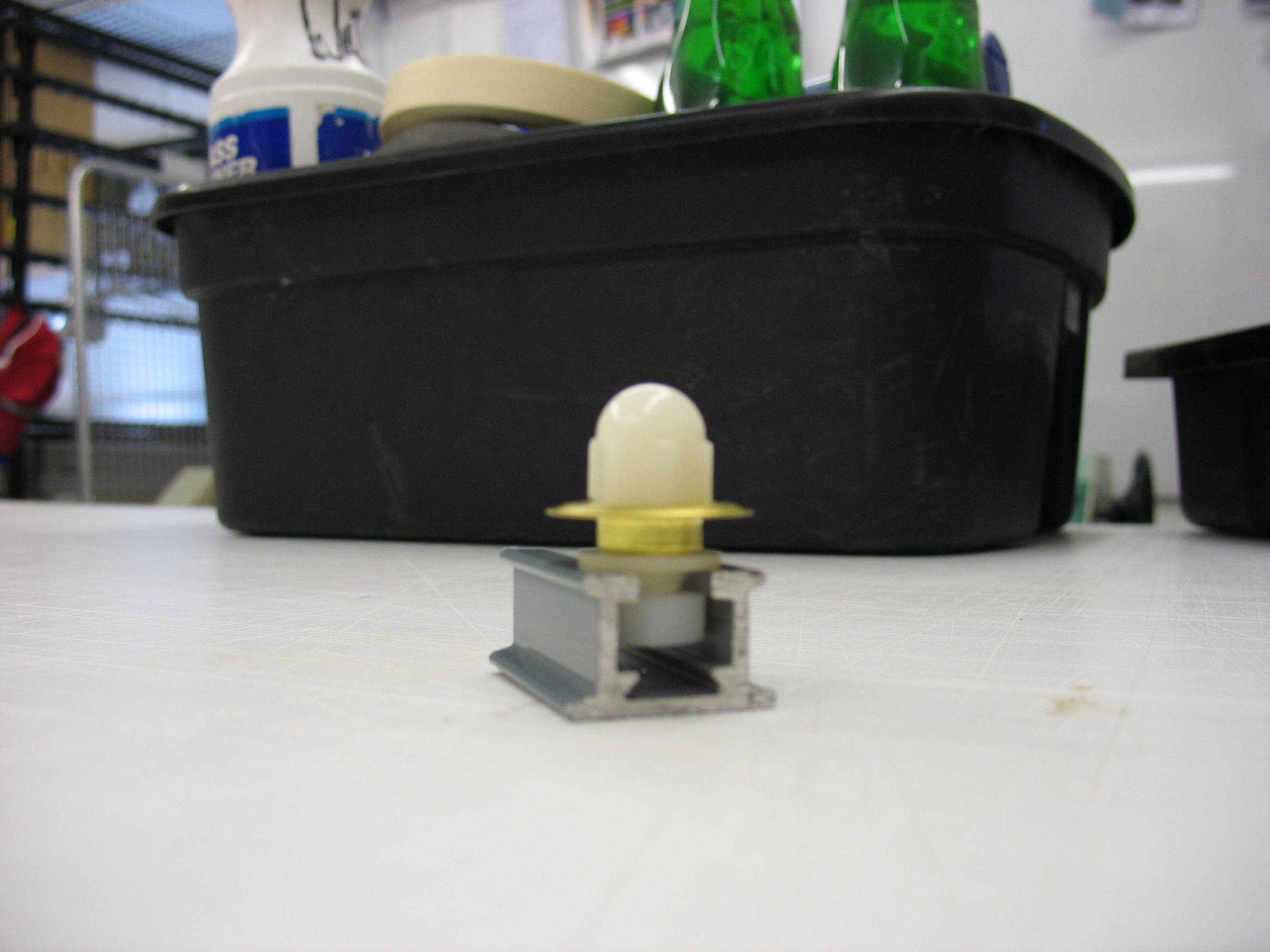

    I’ve heard of banner track before, you just screw a lenght top and bottom and then you thread a bolt into the track which goes through the eyelet and then you wind a nut onto the bolt. A company called Hampshire Flag use to sell it, it means you can constantly change the banner with no problems.

  • Derek Heron
    November 30, 2006 at 10:02 am
    the system described by peter is available from boldscan i have used it
    and it is ok but the banner will not be flat to the boards
    See pic hopefully attached .
