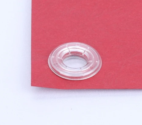

    Hi Peter,
    I don’t use clear eyelets but I sell plenty of them, the main advantages are they don’t rust, you can see the print through them and also if used with non pvc banner they can be recycled without being stripped off the banner

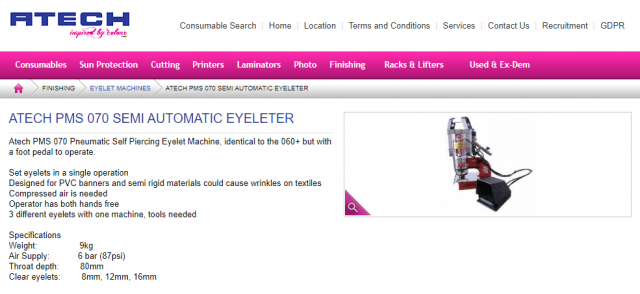

    We’ve got one of these.
    http://www.atech.co.uk
    Great little machine and if you have any quantity of banners forget the hand press options.

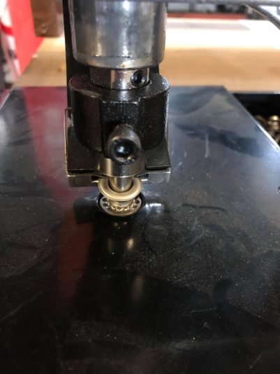

    the one i bought has no bottom eyelet part it spreads the top part once it has cut the banner on top of a die making it even easier to use , you just load the top box with a few hundred eyelets and work away

    I am tempted to just order one of these and give it a go. at £140 it’s not exactly a big gamble. my only concern at the moment is how the single eyelets flares out to grip the banner material. I don’t know if it will have the same grip to prevent the banner tearing at the eyelet because the eyelet is gripping material rather than gripping the female part of the two-part metal eyelet if that makes sense?
    • Patrick Donaghey
      August 9, 2021 at 9:44 pm
      Rob the eyelets are slightly deeper to allow for this ,even when banner tape is used the are brilliant
