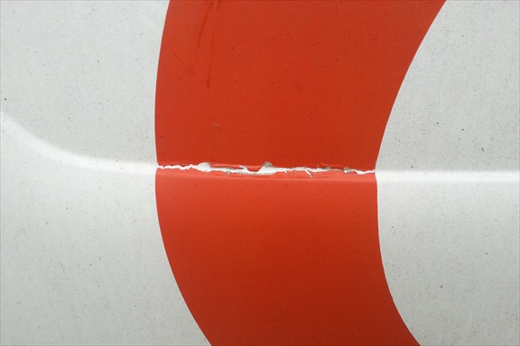

    saw 2 vans today owned by a large crane company
    they run a fleet of vans, so i would imagine they were all done by the same graphics company.
    very bad workmanship i think
    stu

    I see this all the time, seems odd to me that I stick oracal calendared into that type of recess and it stays, yet I’ve used various wrap films that have pulled out like that!
    those aren’t mine btw!

    Its not about educating the customer, we are the experts, they put their trust in us, the professionals to choose the right materials for the job.
    Even if the customer was happy with what’s in the pictures we shouldn’t be, its our reputation thats at stake!
    and anyway theres no reason for that to look like that even using cheap vinyl..
    Not my work either btw 😀

    The vans are not even 12 months old.
    And i agree it gives us a bad name.
    This was on two vans parked side by side,they are a multi national company and own lots of vans.you can bet they are all the same.

    That is bad workmanship nothing to do with the vinyl quality, there is absolutely no reason not to feed the vinyl in to that recess rather than trying to stretch it in, in the hope that it would stay put. In someones defense it looks like it may have had a lot of TFR & jet washing although it could just be the photo.

    There’s various things it could be…
    Wrong Vinyl for the job
    Right vinyl, wrong installation procedure.
    No post heating done after installation.
    recessed area not cleaned properly.
    wrong vinyl, wrong installation procedure.
    the list goes on…
    if its a large fleet, i imagine it maybe the wrong vinyl and the company is using an inferior cheaper product to win the job.
    I certainly do think it is a case of us needing to educate the customer.
    Yes we are the professionals, yes we should know what we are using etc. but i don’t mean just that.
    if we quote for a job using a high end product, we must educate the customer
    why we have chosen this product and the benefits it has.
    why our quote maybe higher than the lads along the street quoting on same.
    you are simply outlining some basics of why "you can" use a cheaper film, but its "false economy".
    unless you outline simple things like this, the customer will always purchase based on price, because they know no better.
    taking 5 minutes more to tell the customer this may win you the job and it will come across as more professional also.

    We also use a 3M primer in the recesses when wrapping. Not sure how much difference it makes but for the low cost we do it anyway…we’re also using 3m wrap so vinyl warranty should be ok.
    April 22, 2013 at 9:13 pm
    3M 1080 isnt warranted in recessed areas mate but their digital wrap film is.
    from what i have heard the primer shouldn’t really be used. exactly why it shouldn’t be used im not sure. i actually have it also, used it once but since hearing that i stopped.
  • Jamie Laird
    April 22, 2013 at 10:20 pm
    Yes it’s only the wrap film/laminate we use in recessed areas. Interesting about the primer, thanks. Does it potentially contaminate/compromise the adhesive on the vinyl? I must admit it wasn’t mentioned on the 3M/William Smith course, so perhaps there’s a reason they left it off. We came across other sign makers using it and it seemed like a good idea but now we’ll reconsider.
    April 22, 2013 at 11:24 pm
    the 3M digital media is warranted for recessed areas, so there shouldn’t be any need for the primer mate.
    because i dont actually know for sure, i dont like state anything, but as a guess, ide say it maybe cause issues when the vinyl comes to being removed. in as much as it might leave allot of adhesive residue, when high end brands should leave minimal or no residue. as i say, uneducated guess. 😀
    what i would suggest is buying at least the small 3M pressure wheel.
    there are two, large and small. these should be used in recessed areas to promote adhesion. i would advise any wrapper to use these wheels regardless to which media you use.
    you can buy them from Wm Smiths, not cheap, but worth it in my opinion.

    I also see that on vehicles all the time, It was just not the right vinyl for the job, no matter how much care you take putting on the wrong vinyl in a recess like that it’s just not gonna work, i wouldnt fully put it down to bad workmanship by the installer as I used to work for a guy that used cheap vinyl for almost every application and no matter how carefull Iwas the job just didnt last. I know some customers always want the cheaper option but as someone already said its up to us the professionals to put them straight, I certainly wouldn’t put my name to a job that was’nt going to last.

    putting the vinyl in using your finger is fine mate, but follow it up with heat and a pressure wheel. it promotes the bond/adhesion.
    you can of course put the vinyl in directly using the wheels, it does work but is tricky on corners and not easy to to get straight into the corner of the recess first hit.
