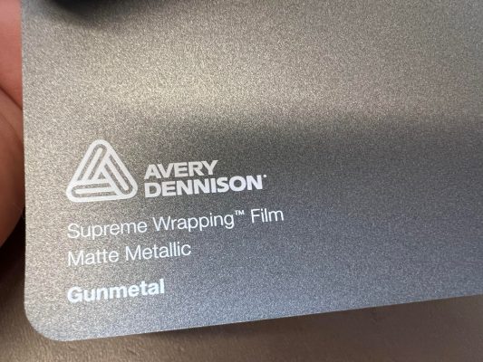

    Avery Supreme Wrapping-Matte Metalic Gunmetal – alternative cheaper vinyl suggestions, please.
    Do you know similar look vinyl (7 years) for a cut job, any manufacturer?

    I’m at home so no swatch, but try the Metamark Metaglide range, looks very similar to one we used on a van a few months back.

    Nope ive looked through all my stuff nothing comes close enough for a match. Closest i can find (darker) MM64 matt metallic graphite Mactac colourwrap

    Oracal 970 matt 932 Graphite or 937 Charcoal might do the job. MacTac do a dark metallic grey cutting vinyl – 9889-01 Charcoal. Might be a bit dark,
    and it’s gloss.
    Avery 746 is a dark grey metallic, which is quite matt.

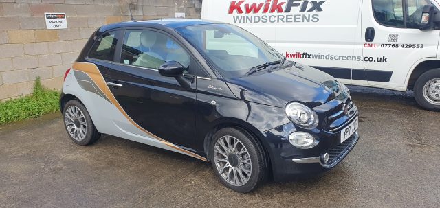

    I quite like the Oracal 970 if it has to go though a plotter.
    It is a little thicker than the others so works well. I’m sure that there is a matte mettalic too.
    Just completed this little guy yesterday and it was all cut from the product.
