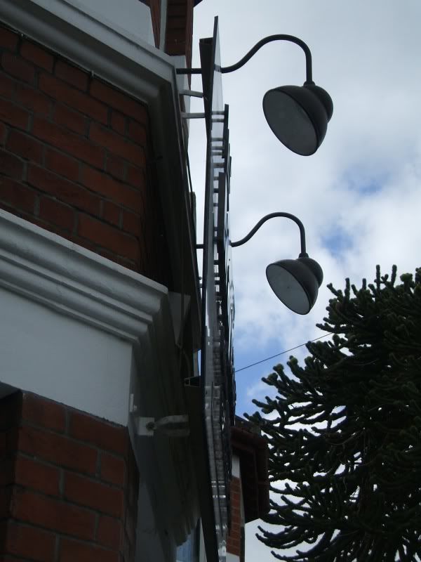

  • Warren Beard
    November 11, 2009 at 12:44 pm
    here it is.
  • Andy Gorman
    November 11, 2009 at 12:46 pm
    Make yourself some frames from ali box section 900 x 150 and fit them vertically? The wind’s going to get behind there though. Also, you say house – I don’t know about up your way but down here you’re only allowed about 1/3rd of a square metre on a house.
    Having seen the picture, change that to horizontal!
  • Warren Beard
    November 11, 2009 at 1:08 pm
    thanks Andy but there is not that much space without running it in front of the window, it basically needs to be on "legs" as the current old one is, I would have done a similar fixing but have never seen those before and thing they might have been specially made.
    Do you think a square tube post 100mm long (+50mm into return) attached to the fixings rails would work? I would get a base plate welded on to the base to fix 4 masonry bolts on each of the 4 posts?
    Does that make sense?
    cheers

  • Kevin Flowers
    November 11, 2009 at 1:38 pm
    Warren
    this how i would do it, but can fabricate metal & powder coat myself now i’m working from the new unit. I would suggest you find a local steel worker. Hope this helps

  • Gwaredd Steele
    November 11, 2009 at 1:41 pm
    can you not re-use the existing brackets?
  • Warren Beard
    November 11, 2009 at 4:37 pm
    Thanks Kev, that makes sense and will work and also will be one piece which will make it easier to fit, just have to find somebody who can make it for me.
    I thought of re-using the existing brackets but would be more hassle and would have to remove his sign while I make the new one and I’m not sure they will be happy about that.
