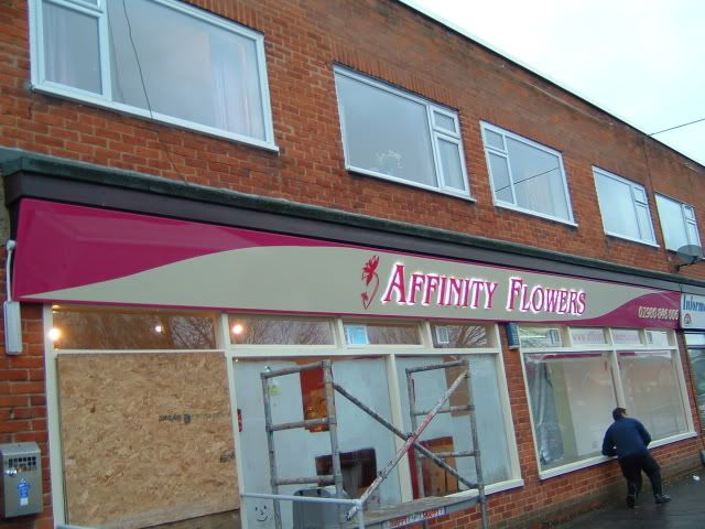

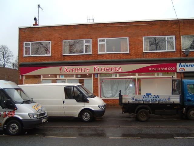

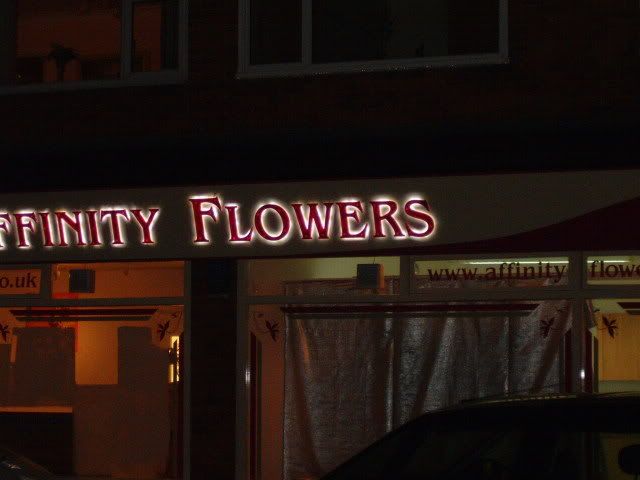

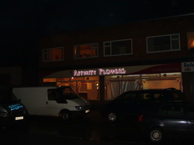

    Well, the job is finished & I think we got there in the end! At the last moment, the customer changed his mind from wanting red LEDs to white ones, so a mad dash up to Ashby signs was needed, & I also decided to paint the insides of the moulded letters with white acrylic paint in a bid to reduce the see through effect. If I had more time & money, I would have painted them black after this until virtually no light could come through. As it was, we didn’t, & only just had enough time to apply the white paint, so you do get a bit of bleed, which is a shame, but the effect when passing is brilliant & the customer is over the moon. The addition of mat vinyl as a diffuser to reduce spotting & reflection worked really well too.
    As for wiring the LEDs, I decided to wire them in series & to do this I ran a length of cable from the transformer to the last letter, then took a spur off it onto each letter. I figured this would be better than running them in parallel as A) you only drill one hole for the wire at the top of the letter instead of one in & one out, & B) if one connection fails, it only takes out that letters lights rather than all (if the A failed for example) & this is easy to trace.
    In hindsight, if I were to do this again, I’d go fret-cut with moulded letters & the LEDs in the tray rather than behind the letters, but seeing as the tray was in the paintshop when the customer decided to have LEDs after all, I guess hindsight would be of no use anyway:lol1:
    Cheers for all the helpful suggestions with this. Here is the finished sign. 40′ x 26¼" aluminium sign tray with 60mm returns, wet coated pink with Avery 700 series vinyl cream infill, Mactac 8900 mat text under Accent signs pink moulded letters with Sloan V series white LEDs from Ashby.
