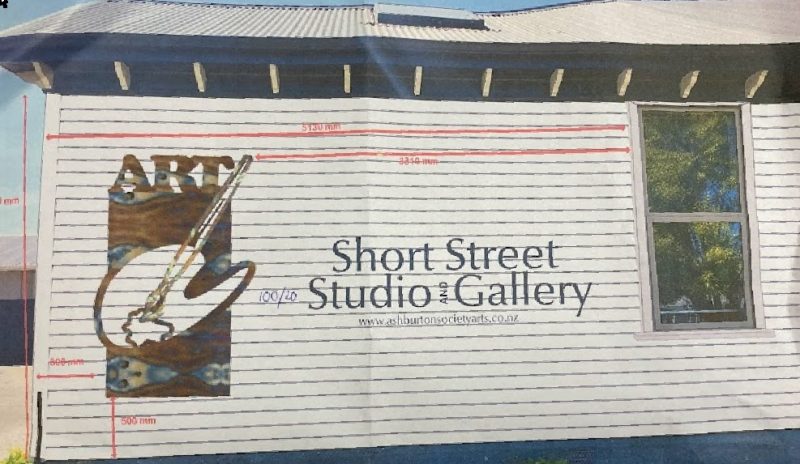

    I have a small vinyl job to do on an old painted wooden building.

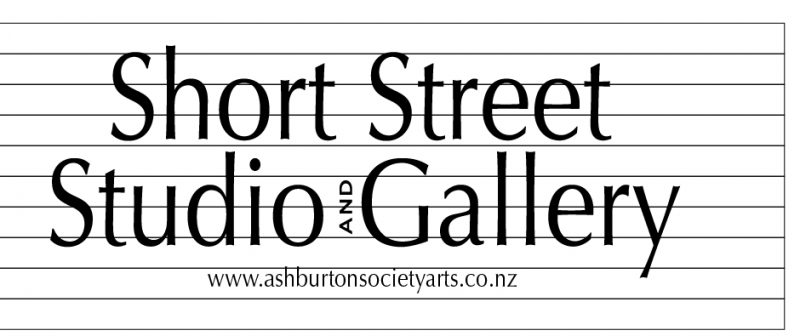

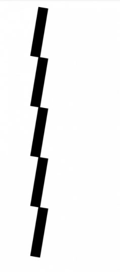

    The surface is made up of 100mm wide planks on an angle that faces upwards, with a 20mm return. Heres a diagram of the wall from the side.
    Presumably this means I should stretch the design vertically by 20%, to make up for the hidden 20%.
    But that looks a bit weird and obviously distorted.
    How would you handle this job?

    I would do the lettering and print at normal size without any distortion and simply cut along the edge of each plank when applying it so the top edge of each remains bare when the vinyls are applied to the front face of each plank

    * Apply the text as you would normally and slit against the edge of each plank. “allow it to roll over the edge slightly though. so you do not have an exposed edge”
    * Then drop the trimmed vinyl down onto the face of the lower plank, apply it, trim against its edge and repeat.
    * Once you have completed it, stand back and if you feel that you can see the underside of the “returns”
    Simply apply strips of 20mm black vinyl and trim to meet the letter face.

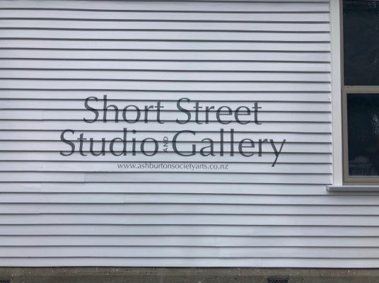

    Job done. I took Phills and Robs advice, it worked out well.
    I didnt really need to fill in the gap on the underneath, even though it can be seen from the road, the shadow thrown by the plank above completely hides the missing section of the letters.
    The building was newly repainted with acrylic gloss, so it stuck well and I dont think it will be coming off.
