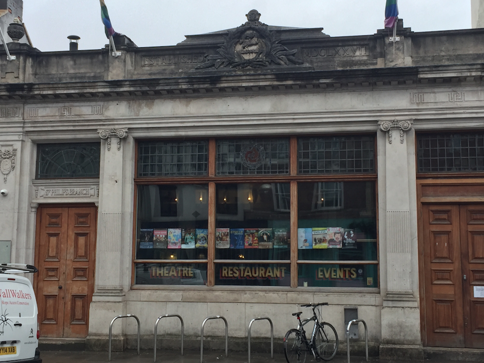

    I’ve been asked to apply matt black vinyl lettering to this building. Can anyone suggest a decent vinyl that will adhere to this type of surface please?

    Interesting question. I’ve done floor graphics “Shoe shapes” stickers in the past and stuck them to pavement slabs outside my shop. They lasted for few months before council cleaners removed them. So my guess will be brick wall vinyl or floor vinyl. But not sure of durability.
  • Iain Pearson
    April 5, 2019 at 1:01 pm
    Could it not be done out of 3mm black forex with 3M tape on the back ? – just a suggestion
  • David Stevenson
    April 5, 2019 at 1:05 pm
    If you’ve a printer and cutter a material called roughmark should do that nicely. It’s designed to stick to some of the worst surfaces imaginable. Just done 5 walls made from big croncete blocks!
  • David Gwyndaf Povah
    April 5, 2019 at 2:27 pm
    aslan do a wall wrap digital film very good for rough surfaces i have used it in the past with no complaints.
    aslan-schwarz.com
  • Joe Killeen
    April 5, 2019 at 3:31 pm
    Arlon DPF8000 print and matt laminate, made for brick and concrete.
    Joe
    arlon.com
