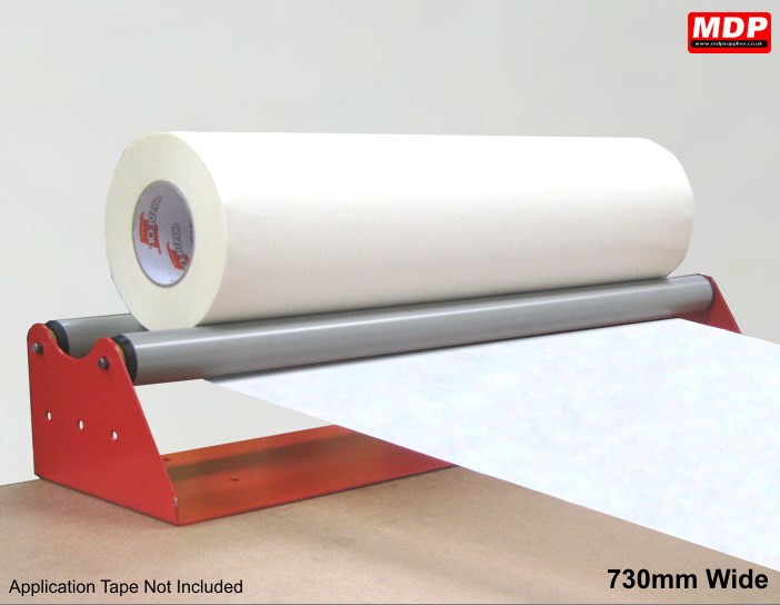

    July 16, 2017 at 10:51 pm
    one of these will do the trick very well. cost about £70 from memory.

    Thank you Rob. I have one of those but still struggle with the larger wall stickers. Maybe I am using it wrongly. Christian

    we use the same 650wide machine as Rob posted, I have also used the 1200+ version in the past and it’s fine. I must buy one for here as I’m taping more larger graphics.
    The trick with thos dispensers is to pull the app paper all the way over and past your graphic, then kind of float it down onto the decal, if you do it at one end and work back it can lay the tape tight and cause wrinkling when rolled or even stored flat, just drop it in the middle and lay it onto the graphic before squeegying down.
    With practice you’ll almost be laying it at the foot of the dispenser and laying it along the length of the graphic. I find that by pulling it all the way out over and just giving it a couple of seconds befor lowering it onto the graphic, any stretch from pulling ot off of the roll is minimal, the paper has time to replax again.
    for long or multiple graphics at 1220 wide I’ll mount the app paper on the laminator and run it through on that!

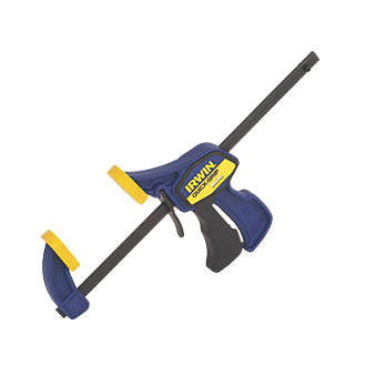

    it also helps if you speed clamp it to the bench. Has to be one of the best and useful bits of kit you can buy, had mine for 14 years now

    Hi Chris,Thank you for your reply.
    What does a speed clamp look like?
    Christian.
    July 18, 2017 at 1:11 am
    This is a speed clamp or quick release clamp 😆
    Looks like the one Derek has pictured is home made, I made one for myself as well which is fixed to the end of the workbench, mine ended up being a bit more elaborate than the ones you can buy though 😆 😆

    I have both the 730mm and the 1349mm bench rollers that Rob showed a photo of, but the problems I encountered, especially with larger applications, was the static. When I pulled out a large length of app tape, as I started to lay one end down, it was a fairly regular issue that the job would pick up from the bench and stick onto the tape, nearly always resulting in wasted vinyl and tape. I used to stick the sides down to stop this, but this seemed to take up too much time. Not too sure if this is a problem with the paper tape.
