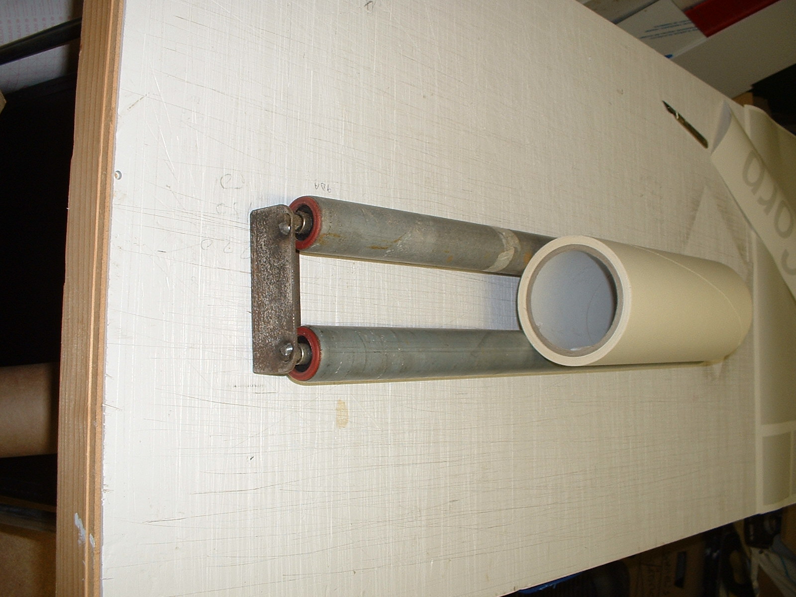

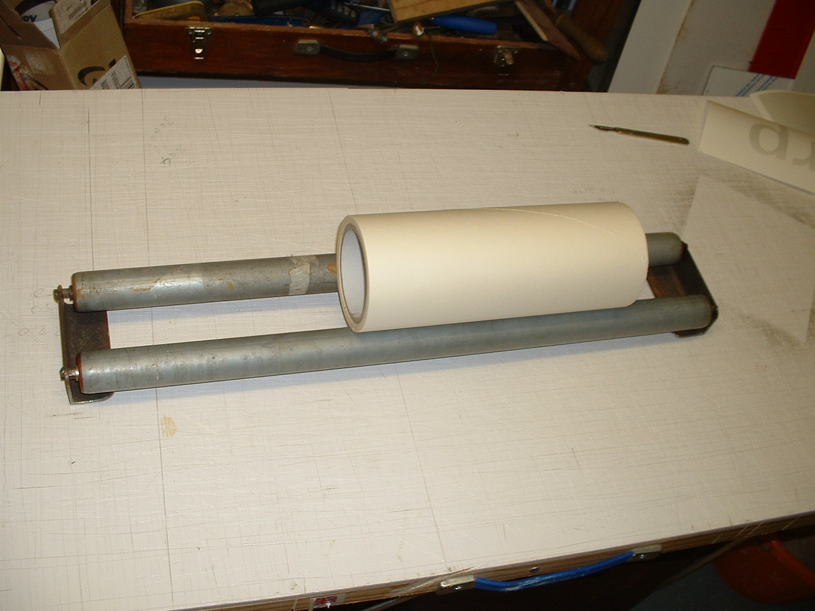

    Posted by Chris Windebank on January 30, 2007 at 3:52 pm
    After reading about tape dispensers on another thread, I thought I would post a pic of the one I made. Went down the scrap yard and found a set of rollers, made two angle brackets and bolted either side. This then can be bolted to the bench or can be used clamped wherever you need.
    Hope this helps

    Hi Chris
    That’s a great idea thanks.

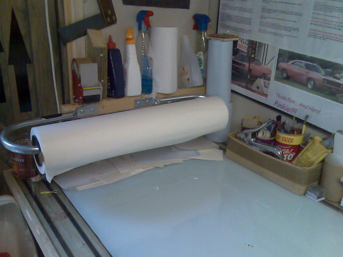

    good idea that, though i wouldn’t be able to use it on my glass tops!!!
    here’s my contraption, soon to be junked in favour of one that allows me to quickly change roll sizes. cost about £9 from focus for the bits.

    That looks good Chris… Looking for something compact like that for 1220 rolls…. Wouldn’t you just pull the roll off the rollers tho.? If anyone knows of something like this on the market would you let me know.?

    chris, thats like the one i bought years ago from signmaster systems, it has wee black stoppers cheryl to stop it moving with the tape, it worked ok for me 😀

    Blimey that was a while ago I made that. Brought one later on with a flange and now sits on the bench but have to speed clamp it on.
    Have to say one of the best tools I ever had, simple but effective

    Bought one a few months a go from MDP, Cheryl the roll can’t pull off the rollers because it is fed under the front roller as in picture.

    steve is correct Cheryl, it does work well and for the money it does the job very well. I bought ours some years back from Hexis but as he says, various places do them "or similar". definitely does pull the roll of the rollers but "i did" put two screws into the base to make sure our lads didnt pull the rollers over. very seldom happens but you do get the odd rogue roll of app tape that wont unravel easily.
