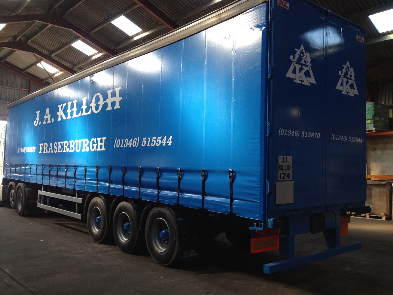

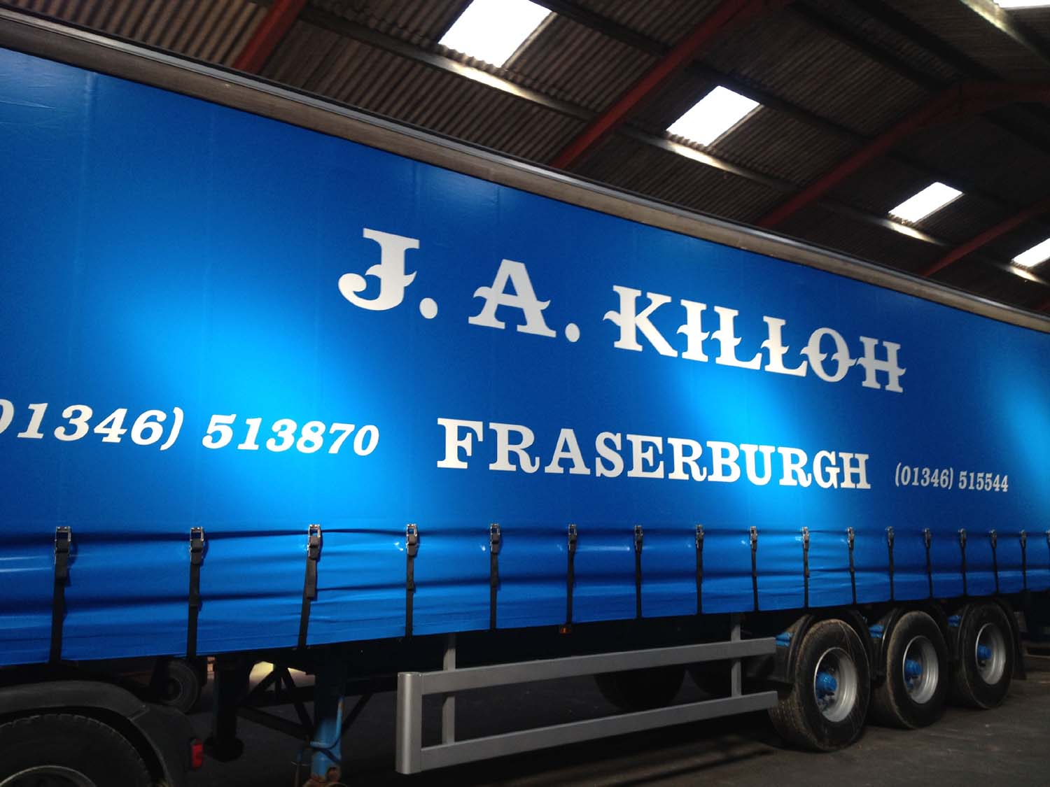

    Just thought i would post photos of the finished job, very happy with it and the vinyl went down very well. another one to do in two weeks time.
    Martin

    nice tidy job, its satisfying when a job you ain’t sure of goes so well
    Kev
    May 9, 2012 at 12:08 pm
    nice job done martin about time these trucks were getting re-done they used to pass my house every day and looked abit well done 😀
