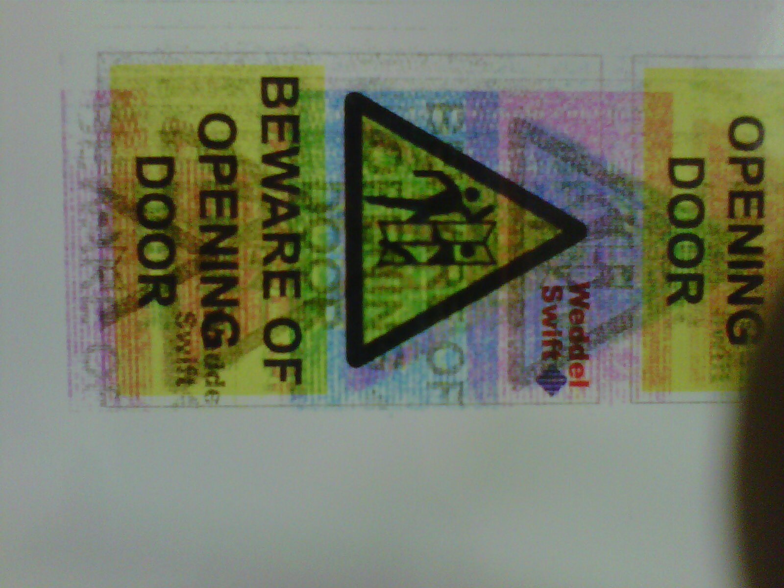

    Hi Guys, Weird one printer working fine on friday night come in this morning and i get
    this on all files i print? Cheers

    not sure…
    could be dirty encoder stripe…. computer screen wipes are good at cleaning them
    Hows the Test print? all in the right order?

    Yep, encoder strip is most likely, or the bar that the head moves along. As Dave says, give them a good clean and try again, failing that, it could be the Y motor on it’s way out or the bushings on the slider bar….?
    Stafford

    Dirty encoder strip or dirty encoder sensor. Clean well with isopropyl alcohol. If this is not working, reverse the encoder strip. It’s an easy operation.
    Have fun!

    this worked cheers for your help guys
