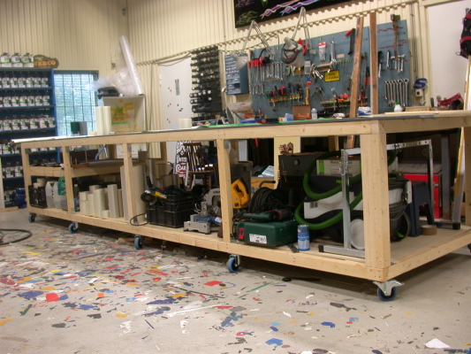

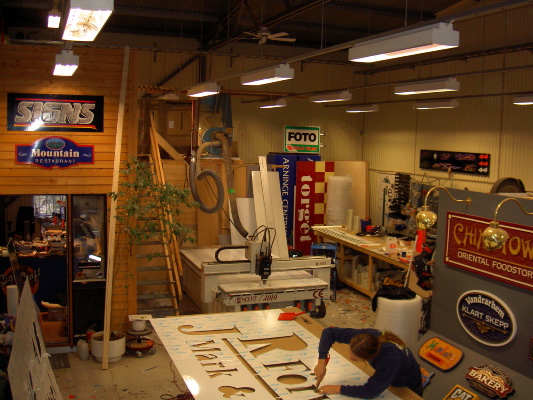

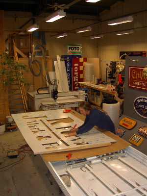

    Posted by Henry Barker on December 30, 2002 at 11:11 pm
    I have been meaning to rework our 2 main work tables for awhile now….about 6 years!
    I have a separate part of the workshop…the Office which is about 50sq m and has the plotters, Edge, etc. Out in the work area we have 3 main tables, these 2 long ones which are 5m x 1.2, so when pushed together we have 10m work surface. However they are abit low for the back, and I had thought of making a frame with a lower shelf area for all sorts and putting them on industrial castors/wheels with brakes, so they were easier to move around, I just wondered before we change things if anybody else had better ideas or smarter solutions.
    and looking back up the other way…

    What is that you have topped your tables with?
  • Henry Barker
    December 30, 2002 at 11:32 pm
    THey are topped with sheets of MDF which we paint every now and then, I did have a large metal sheet over a smaller table 2500mm x 1200mm but found we got alot of static shocks from that. Be interested to hear about what other surfaces people use, maybe sometype of laminate for example, or glass even??

    I forgot about this post….just an update, I built new benches with a work height of 950mm (no more backache) and fitted both of them with 10 blue wheels the same quality that we had on filghtcases i.e they take 150kg each and so the tables are easy to move around as and when, also fitted with 4 whhels with brakes. They are 5m long each and have a Webermade tape dispenser also, each table has a long shelf underneath for moree storage and a smaller shelf for squeegees knives pens, stabilos etc etc.
    and the other one excuse the mess ๐Ÿ™‚

    By gum Henry they’re huge, do you have one of those small tractors like they use at airports to move them around, must take 2 or 3 of you ๐Ÿ˜†
