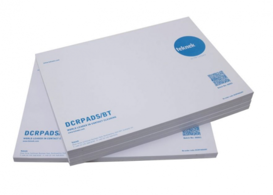

    Hi all.
    Ive been using these Teknek pads with roller systems most of my life.
    I think it’s great but not the cheapest option. Wondered what you guys use?

    Ho rob, use them everytime im laying vinyl onto boards, removes all the dust etc and also as im laminating print before it goes through the rollers

    We use these as well. Used to just wipe down with meths, but the roller / pad combination is so much better.

        The last adhesive pads we bought were from SignGeer, which were larger than the original ones we had, so we cut them in half to get twice the amount. We have used end of roll app tape, but it isn’t as good. You can rinse the roller under the tap, which will bring the stick back, but probably a pain to do every time.
