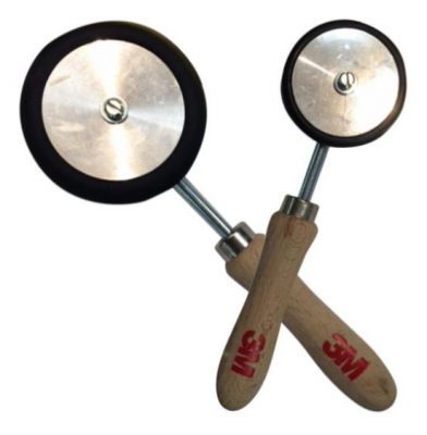

    Also, you will probably have seen the attached 3M wheels. I have heard mixed reasons for their use, my opinion is that they are to compress the beads into the adhesive “within the recessed areas” of vehicles, where maximum adhesion is needed to prevent a failure.
