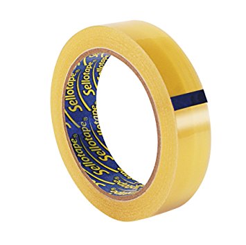

    I remember very well my similar moment when a whole thing fell off the glass because the masking tape failed.
    Ever since, I only use sellotape tape on glass. Winter and summer.
