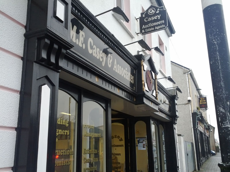

    I have a customer who is looking to change the colour of their existing shop front but wants to keep the same look to the signs. i.e. glass like glossy front.
    I presume that the best way to achieve this would be to mirror cut the vinyl lettering & fit it to the reverse of clear acrylic sheet? What thickness & type of acrylic would be best? (I notice that the existing sign has a bit of distortion to it which I’d like to avoid if possible this time)
    One of my concerns is that whenever I have fitted cut vinyl to the rear of clear acrylic by hand it never looks as good as when fitted to the face, there is always a small amount of air (Squeegee marks) it seems, no matter how carefully you apply it & therefore the colour is not as solid looking. Black or dark colours particularly. Although he is changing to blue, white & yellow so it may not be such an issue.
    Could anyone with experience of this type of sign please advise best way to approach this please.

    I hadn’t thought about the fitting but it looks from the pics like they are held in by the beading. Will have to have a better look if we get the go ahead for the job.
    Myles

    That warping might be due to the panels not being able to expand in the fixing frame.
