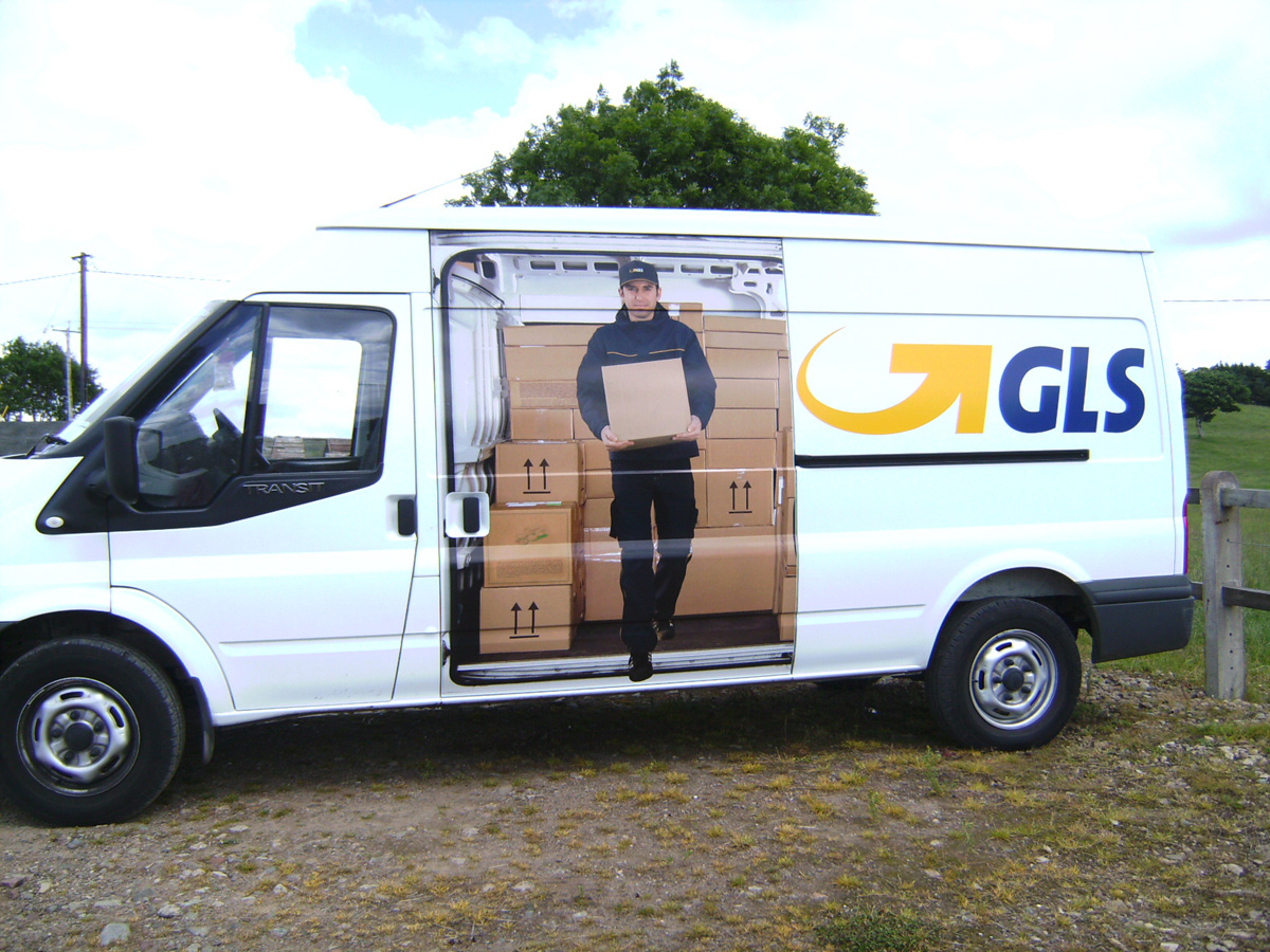

    Cheers everybody for your advice, sorry I didn’t get back sooner but have been crazy busy (great complaint!!)
    Job went ok & was straightforward enough as the door only has a couple of creases & no valleys, (obviously why they supplied Scothcal 40 & not wrapping vinyl)
    The trickiest bit was making sure it started off perfectly straight, as the sticker was supplied cut Exactly to size, nothing left to trim!!?? 😮
    I actually started off dry, then carried on wet. Would anyone recommend doing it all wet (easier to line up from start maybe?) I never normally use wet application, but I think that only having one pair of hands & with a sticker that size I may have made a ba**s of it dry & I only had the 1 shot at it.

    Nice work and clever design.
  • Myles Brewer
    June 26, 2008 at 2:47 pm
    Thanks Rick,
    Unfortunately with this I can’t take the credit for the design, It comes direct from the company, ready designed, printed & laminated ready to fit.
    Cushty job though eh! 😀 , the only disadvantage , like I said, is that if I mess up, there’s no spares 🙁 but fortunately (touch wood) that’s never happened… yet!! 😕

    Myles, you would be better off sticking with the dry application, the more of these you do obviously the easier they become.
    Problem with applying wet is that the water will tend to gather in the recess and you will have trouble with the adhesive taking to the side of the van which can cause it to pull back out of the recess.
    June 26, 2008 at 5:31 pm
    Myles,
    Dry is the preferd way, but dont know how you did it, but i would have taped in place top or bottom and worked from the middle with a hinge, that way you split into 2halves, and less chance to run off.
    Spot on Martin, that’s exactly what happened & it took a good bit of patient squeegeeing to get it to stick in the recesses but worked well then on the flat panels. But like you say it’s practice makes perfect & I’ll certainly try the next one dry

    Yes Peter, I do normally only fit dry, but the size of this one made me a little apprehensive. Never thought of doing it from the middle up or down 🙄 makes perfect sense now you mention it. I lined up carefully at the top & worked down, fortunately it didn’t go off! Will try your method on the next one. Thanks
