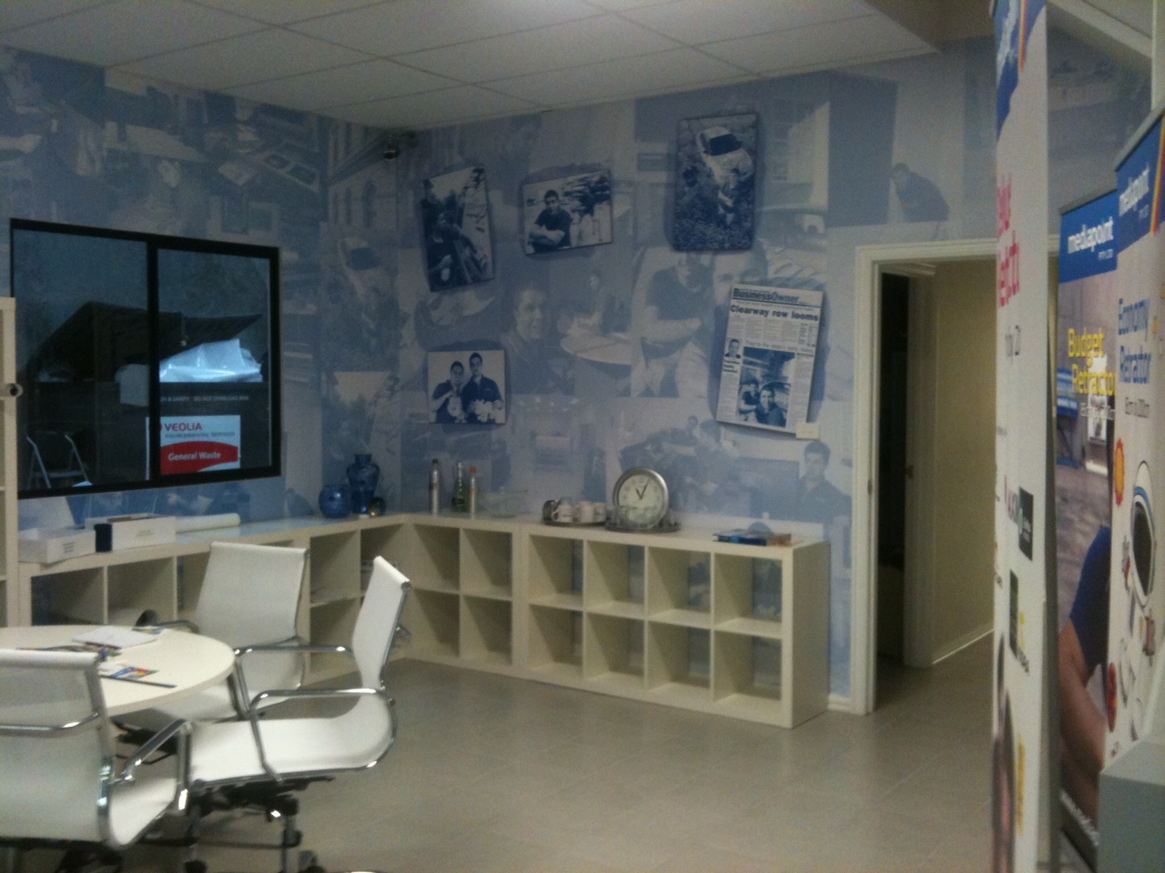

  • Jason Xuereb
    July 25, 2011 at 1:25 am
    Here’s our reception/waiting room area. Hasn’t curled unlaminated. Works a treat. Easy to put up as well as its very thick.
  • David Crocker
    July 26, 2011 at 9:04 am
    wow thats looking good Jason 🙂
