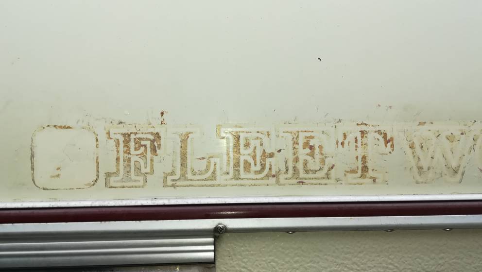

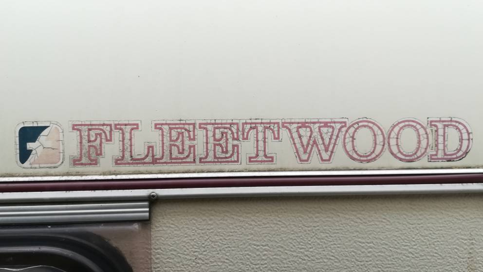

    Hi, I’ve acquired a caravan on the cheap to give it a go before investing too much money on a newer van. The decals as you’d expect are pretty old, faded, and need replaced. Spent ages today with a heat gun trying to get them removed but they’ve left behind a terrible mess. Any thoughts on what I could use to remove the residue? Have tried our normal adhesive remover but might as well use water for all the use it is 🙁 Might end up having to make the new stickers slightly bigger to do a cover up job. Please see images below. Thanks

    Maybe a toffee wheel attachment in your drill will work better than solvents, I recently bought an MBX vinyl tool, makes a mess but saved plenty of time
    I agree with Kevin on this…
    Toffee Wheel or MBX will have that off in minutes.
    The only issue i see is that staining of where the old graphics were. you can see some yellow staining in the pictures. i doubt you will remove that, but i could be wrong.

    Phone around a few body shops to see if they have one you can try, it will cost you a few beers to see if it works, they wear down quite quickly so when you buy (I think you can get them on Amazon) you can get a better idea how many you’ll need

    thinners should remove it and if you dont mess about and wont touch the paint with it being so old
