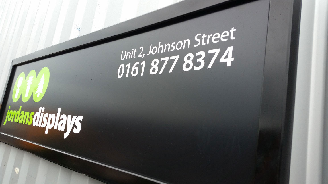

    The original job we quoted on when I first asked this question didn’t come off, but I have since had a 2 jobs requiring sign frames.
    We bought a electric mitre saw for about £150, and two 6m lengths of mill finish nova trim, about £40. As the frame was only small we abraded the trim, etch primed it and then sprayed it black in house using rattle cans, and the finished job looks good, paint is surprisingly durable too.
    For larger frames we’d probably send it off the be powder coated, rather than painted.
    I quite enjoyed producing these in house, and got a lot of satisfaction making something from scratch rather than ordering it in.
