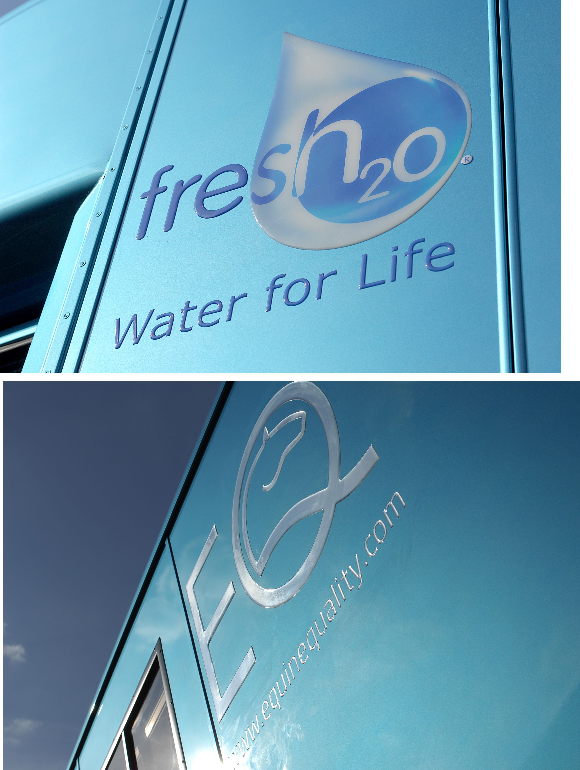

    HI all,
    I’m aware of what doming is, although I’ve never messed with it (just one more thing to sit on the shelf and make a mess with!)
    A customer has enquired about a couple of large graphics, like the attached photo’s and around 50cm x 54cm…
    any ideas where I can get this done / priced up? happy to use someone on here if feasible.
    thanks,
    Hugh

    Try calling Interfax Accuflow 0121 378 2289, they manufacture the resin, I think, I’ve used this company for some years, they are very helpful. It’s not as expensive as you think; you’ll find that £100 will go a long long way.
    The largest single piece I’ve done was an oval printed logo that was about 450 x 250mm.

    Steve,
    do you recall how much resin that decal used? I’m looking at one that’s twice that size!
    Some of the work they’ve had done before was made in sections, ie, the E was made of four pieces rather than one, the height was 550 tall so I may end up doing that but would rather try to do in one piece.
    Is it hard to apply without bubbles underneath? I asume because it’s semi rigid that would go down nicely but the woman this order is for has said they had awful trouble with the chrome ones!

    Hi Hugh, done quite a few chrome badges with no problem. You have about 20 minutes before it starts going off so any left usually gets put on items around the workshop inc business cards, coins, hate to waste it. If bubbles occur use a small torch like a chefs torch and they disappear instantly

    how do you deal with dust as an issue? next door to me is a glazier, I’m going to rob a couple of sealed units from his skip and effectively use one as a taple I can level on the bench, and then put the other over the top (spaced of course) to create a barrier, I cant see any other way really!

    we seal off an area, and then set up a glass panel so its level, stick the stickers with spray glue to that glass, and apply the resin, give it a quick pass with the torch in case of bubbles, then we put 4 large nuts in each corner and pop another layer of glass on top and repeat. As long as the first layer of glass is level, then you know all subsequent layers will be good. Having a layer of glass over the top of the drying resin reduces the chances of dust particles landing in it. We find humidity really effects the drying process so we run a dehumidifier for the 24 hour curing process. hope that makes sense if not i can send a photo.

    Sorry for the late reply. The big elipse that I domed was about 550 X 200mm and used near enough 3 cartridges. As a guide I’ve made hundreds of little badges which are 65 X 30mm and I get a minimum of 17 per cartridge. The variable is: how much you waste at the start of the process, you must give at least 2 good trigger squeezes so that the resin is completely mixed when it leaves the nozzle. If it isn’t mixed properly it’ll never set.
    I do as Dan does with the adhesive, a good craft stockist should stock ‘3M Spraymount’, it’s not cheap but it’ll last a long time and also the small flame torch – Interfax sell them too.
    I made myself a small cupboard with slide out shelves and and a 60 watt lamp in the bottom. The box sits on a shelf perfectly level so the shelves are level as well and with the door closed there is sufficient warmth to held the cure time.Dust of course is not a problem.
    I suggest that you cut some shapes and smallish 30mm bold sans serif text and experiment, you’ll find the sharp corners are difficult if not impossible – particularly inside corners, I seem to remember that about 4mm radius is about minimum.

    I’ve only used it for small jobs, the customer (ex customer) buys them directly from somewhere else who specialise, then only calls me an hour before the lorry is due to be shipped, or to finish a bit of wrap missed by whoever is wrapping them in 3m cokourflow!!! I digress..
    Accuflow, I bought a 50ml kit, use semi rigid resin, 3m mount spray, etc. works well, just remember not to overload with resin – the warmer it is in the room, the further that damn resin spreads if it overflows !!!
