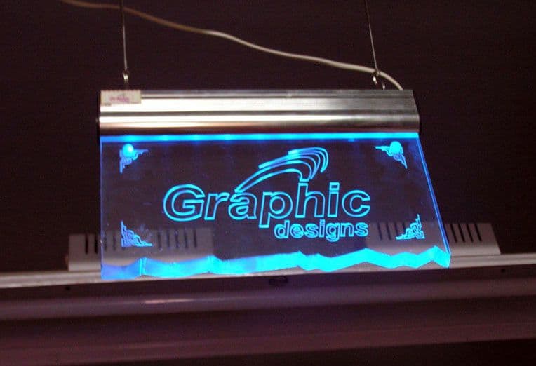

    HI Erdy, I can’t for the life of me understand how you could possibly illuminate the letters without cabling of some type. As of yet the only way to transmit electricity wirelessly apart from close contact phone/tooth chargers is lightning. At 30 million volts and 30,000amps this might be a bit much for your letters! The only thing that springs to mind is edge lit acrylic. This gives the appearance of individual lit letters but depending on where the letters are going hiding the light source might be a problem. You can also get a flat self adhesive wire which you could possibly hide in some way.
