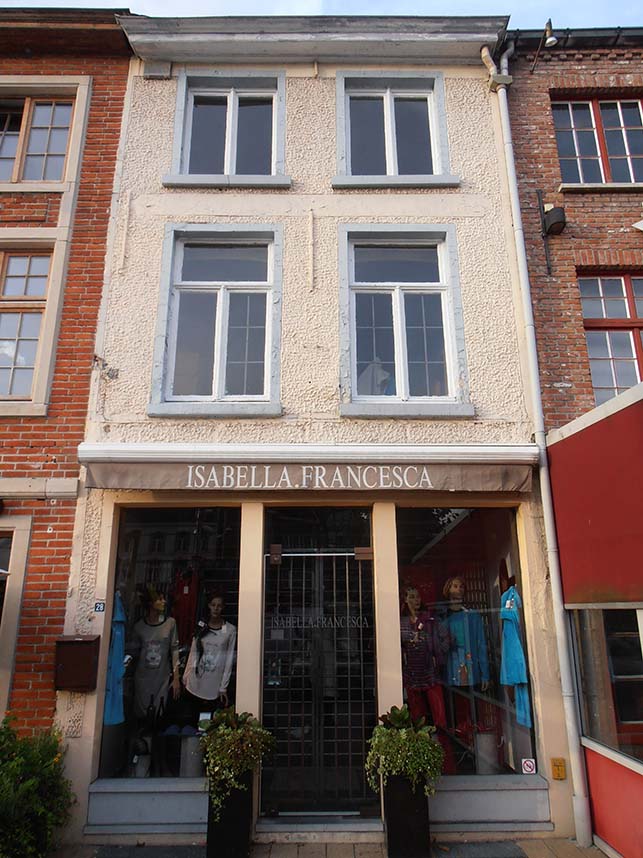

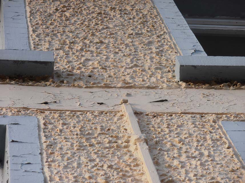

    My first idea is print on 2 panels with size because I really want no frame being visible… The problem is that the exterior is not flat at all and I would have to flatten it out by making a frame and then mount panels it.

    the only other… very time consuming way, would be to make a large (heavy) frame and bolt it to the wall – making sure the surface was flat/horizontal, then fix the panels to the frame – much like an internal dry wall.

    using a flexi sign means the extrusion is what builds the whole thing our from the uneven areas, such as the sills. then a single skin tensioned means zero joins on the face. printing direct to media also means lower production costs.
    you wont see a frame either as it finishes almost flush to the edge of the extrusion. all you will see is the return, but the return can come powder coated if need be.
