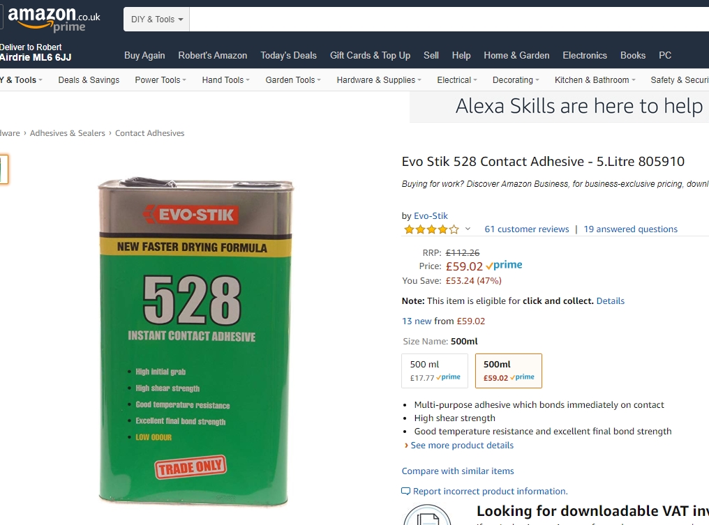

    I’d probably go for Evo-stik – used as it says on the tin. Probably best to lightly key both the board and the Foamex with rough sandpaper and dust off well with a damp cloth and isopropyl or something similar.

  • David Rogers
    6 October 2013 at 19:07
    Evo-stik 528
    Best described as the devil’s snot.
    Use in a WELL ventilated area.
    Stuck dozens of foamex boards to ply with this stuff.

    For indoor what David says 528, but don’t worry about the well ventilated room bit, it’s more fun in a tiny confined space 🙂
