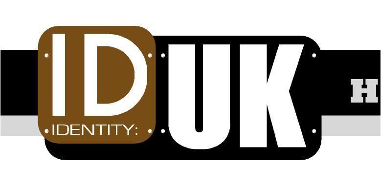

    I will be fitting a DiBond Tray (50mm return)
    Size: 625mm x 6580mm (2 foot X 21.5 foot)
    I want to attach 2 pieces of acrylic to the face of the tray.
    Large Size: 900mm x 2000mm (3 foot x 6.5 foot)
    Small Size: 850mm x 850mm (2.8 foot x 2.8 foot)
    thickness = 6mm
    small piece of acrylic stuck to face of large piece of acrylic and then both attached to face of tray.
    Will VHB tape be sufficient for acrylic on to acrylic and then acrylic on to DiBond tray taking in to account size and weight and material?
    (Logo on this thread to view – https://www.uksignboards.com/viewtopic.php?t=27408 )
    Thanks all
    Warren

    The reason I didn’t want to use stand-offs are because the rear tray is 625mm and the logo is 900mm, therefore the stand-offs would not be able to go in the corners of the logo as these are suspended in mid air 😮 :lol1:

    Warren, not sure if I understand your reasoning on this one, I know that the Logo panel is bigger than the tray and the stand offs won’t fit in the corners but that shouldn’t matter, if you bond the two panels together then there still won’t be anything at the corners of the Logo panel.
  • Warren Beard
    May 18, 2007 at 5:51 pm
    Hi Martin
    I have put white circles where the stand-offs would go and I don’t like them there.
    If they were only stuck from beneath and not through the acrylic to see on top that would be OK but otherwise they would look odd in this position.
    May 18, 2007 at 6:52 pm
    Warren, Big Head fastenings would be bonded to the back of the panel, nothing comes through the panel to the front face so you won’t see anything from the front at all which is why I suggested using then. I personally hate seeing fixings in the front face of a sign and try not to use them if possible.
